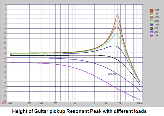

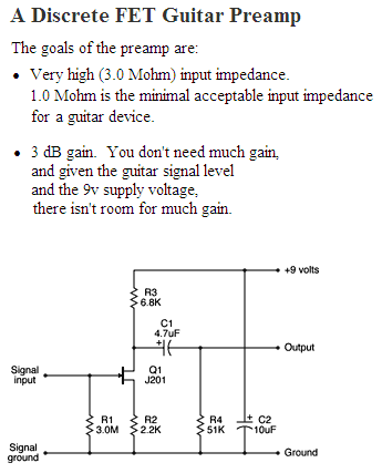

The output from a magnetic guitar pickup is at a level much higher than a microphone. A mic input on an amplifier has way too much gain and an impedance that is much too low for a magnetic guitar pickup. The guitar pickup is usually fed into a Jfet that has a very high input impedance and low gain so that the "twang" 4kHz resonance is boosted like this:
According to your graph, it looks like a 47K load would be best. That peaky response at 1Mohm input looks icky to me.
Players and listeners of electric geetars want the sound to be as BAAAD as possible with lots of fuzz (distortion). The loud sounds of their band has deafened their hearing so they like to hear the 4kHz peak.
The cheap speakers on a geetar amplifier also have a resonant peak at about 4kHz.

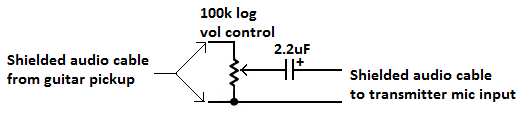

So do I need to mount a preamp between the guitar and the transmitter?
And can I simply use the pot to limit the signal from the base station to the amp?
The transmitter probably uses a voltage to power an electret microphone. Then a coupling capacitor must be used to block the DC from going into a 100k logarithmic (volume control) pot, try 2.2uF.
Try it, but the guitar will sound muffled without a high impedance preamp. Connect the few parts like this:
Why doesn't your amp have a volume control? Or use the pot in between the guitar and the transmitter instead.

The very high input impedance of the Jfet preamp I showed allows the inductance of the magnetic pickup to resonate with cable capacitance producing the peak in the frequency response at about 4kHz as I showed to allow the guitar to produce the electric guitar "twang" sound. When the peak is reduced then the sound is muffled but is fine for a bass guitar. An acoustic guitar does not need the peak.
