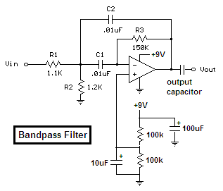

The circuit that you attached assumes you are powering it with a positive and a negative supplies. It can be powered by a single 9V battery if you connect it like this:

yes, thats where i got confused, i was working from the second circuit on the page, that had no power specified.. i've input into Edwin the opamp that displays these power terminals..
so in your examples audio guru, the inverting single supply seems to be most viable for me.. those two 12V designations, can both be connected to a single 12V power rail?

Keep in mind that the source impedance is to be added to R1 but if the source is another op amp, the source impedance will be low enough to neglect. BTW, what are the bandwidth requirements of the filter? A bandpass filter can be stagger tuned for a limited range but for wider bandwidth, using lowpass - hipass filters are best. If you Google you may find a program to design the filter, it is not a simple task.
The points marked "9V" in my schematic are the same power supply connection and can be 12V instead if you want.
This bandpass filter passes mainly a single frequency and has steep slopes at its peak frequency then the slopes became less steep at frequencies away from the peak.
Feed it with a sine-wave to test it. The amplitude of the input signal must be reduced at the peak frequency because this filter has gain at its peak frequency.

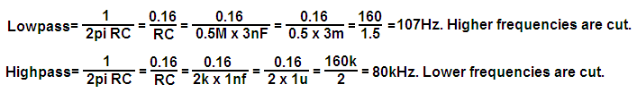

Your opamps have way too much gain.
The first opamp has a gain of 500.
The second opamp has a gain of 250.
The third opamp has a gain of 500.
The total amount of gain is 62.5 million which is rediculous.
The lowpass filter cuts frequencies above 107Hz.
The highpass filter cuts frequencies below 80kHz.
Completely wrong! Almost no sound gets through.

Your calculations for the filters are wrong. Their frequencies are backwards.
You want 625Hz to pass but the lowpass filter cuts it 14db.
The highpass filter cuts 625Hz 42dB.
The total cut at 625Hz is 56dB so the output is nearly 1/1000th. The filters have opposite phase shifts that cancel the signal and reduce its level even more. -87db is less than one part in 20 thousand.
Those are the simplest filters known to man (and woman?). There is not a flat section. Use 2nd-order Sallen and Key Butterworth filters for a flat section and sharper cutoffs.

Damn, I thought my calculations where correct once I’d achieved the, rough, freq response that was required.
My original calculations where
Fc = 1 / 2 x Pi x R x C
LPF = 1 / 2 x Pi x 10k x 1 nF = 15kHz (cutting higher)
HPF =1 / 2 x Pi x 500k x 1 nF = 318Hz (cutting lower)
Are these values correct?
