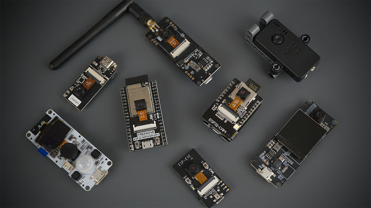

yes sir, I need wifi. and a controll interface on the mobile phone - an app in which you'll be able to set what kind of product are you making and fine tune the heating program.
Sounds like an ESP32-CAM module would be ideal. Wifi, Bluetooth, Camera and I/O with a fast ARM CPU.
From $10, depending on the exact version.
