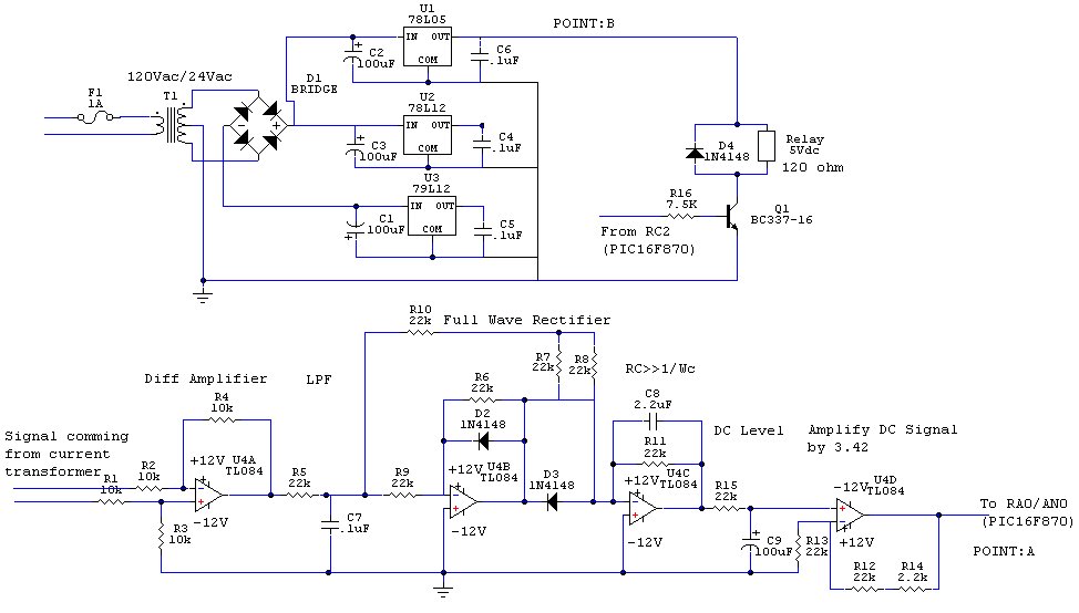

I noticed that when I measure the groung with an osciloscope, I do not have a flat line at this point.
is it normal? or I have problems with mi ground.
My voltage source is a +/- 12 volts the source of this DC voltage comes from a central tap trasformer 24V ac. The central tap is the ground, and here I connect all ground point of all my digital circuits and an analog signal that is acquired by a differential amplifier configuration.
Also I have noticed that when a relay is on my rectified signal that comes from the differential amplifier is noisy, it has disturbances.
Does I have to put a diode in serie from the regulator of 12V to the relay?
thanks
Please draw a sematic for better understanding.
Anyway, try connect the relay before the regulator, with appropriate serial resistor.
This is the diagram I did, that I would like to know if there some problems with the ground. In fact, the +12V (POINT:B) have some problems, when the relay is activated, also the POINT:A.
the DC level has ripples, (a small ac signal), I don't like it? when the Relay is on.
When the system starts I have a big DC signal at the output on POINT:A before some seconds it reach a stable level, according to the voltage generated by the current on the differential/current transformer.
If you have some commenst, all are welcome.
by the way, I put the ground of the oscilloscope at the ground point in the circuit.
Thanks in advanced
You don't have much in the way of a reservoir capacitor on the output of the bridge rectifer, a 1000uF or so would be nice!. As it stands I would suspect you probably have a lot of ripple on the input to the regulators - you can check with the scope.
Your relay is marked as 5V 120 ohm, and connected to a 12V supply?, this isn't going to do the relay any good, and it will also overload the 100mA regulator which feeds it - 120 ohm at 12v equals 100mA, plus whatever the opamps take.
If your supplies are poor to start with, full of ripple, and unable to provide enough current - it's not suprising it doesn't work very well.
I see some problems:
1/ 24VAC rectified is dangerously close (34v) to the +35v rating of the 78L12 and over +30v for a 78L05
2/ You switching a 5v relay on a 12v line. The 120 Ohm resistance will draw 100mA from this regulator which is the max current spec for this with some heatsinking. See note 2 of National's datasheet.
3/ U1,2,3 are drawn with no GND connections.

I have corrected the diagram, the relay is fed with 5 volts.
what you recommend me to do with the transformer, Does I have to change it by 12 volts AC
The relay seems to be running off the 5V rail. Anyway, as what Nigel has mentioned, you lack a large input reservoir. Also, try using 10uFs, if not 100uFs for your regulator output caps. Lastly, maybe this was left out in your schematics, you did ground your regulator COM pin right?
I made wome mistakes while wiring the circuits in circuitmaker
but in real life all are wired correctly.

1: a 10,000 uF at the output of the full wave rectifier will be better instear of the 100uF
2: a 100uF (electrolitic) capacitor will be better instead of the 0.1uF ceramic capacitor
3.- the 120/24 transformer will be changed by another one of 120/12 volts,

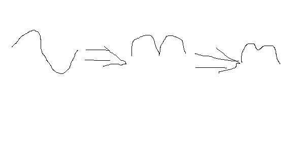

It's stated in your schematics 120Vac. You sure no ripples? :shock:
Anyway, the diode bridge merely provides full-wave rectification. A large capacitor is required to smooth it out. See my pic. Apologies for the bad drawing :lol:

I went to buy some electrolitic capacitor, I will put right now a 470uF 100V capacitor, this is the largest with the small size. bigger capacitors are enourmous.
Does I have to change the 0.1uF cap by some of 100uF at the output of the regulators, too?
does I have to put a resistor in series between 5V and the relay?
I found ripples in the input of the 12V regulator, with a cap of 470uF at 100V it was better, however, at the input of the 5 volts regulator it is ok, no ripples with a electrolitic cap of 100uF at 50V.
