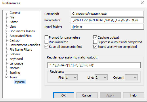

Update, got it working for the most part.
Need to work out how to make it generate the .err file with the same name as the file being compiled instead of %1.ERR and also to stop it outputting an .0 (object) file.
Tool preferences window below and this is what is in the parameters window:-
/e%1.ERR /aINHX8M /W0 /Q /L+ /X- /C- $File
...and also to stop it outputting an .0 (object) file.
I don't think you can, even though there's supposedly a commandline switch to stop it.
I've never been able to get it to work and that's going all the way back to mpasmwin 5.51 from mplab 8.92.
Seems to be hard-wired to generate a .O file.
It's not really a big deal, just my OCD saying why generate it unless it's needed :) - I generally delete all the extraneous files after a compile anyway.
MPlab 8.92 is the same - I have a vague recollection of a discussion (possibly on the Microchip forum) quite some time ago about stopping it being generated but not sure if a solution was found then either.
