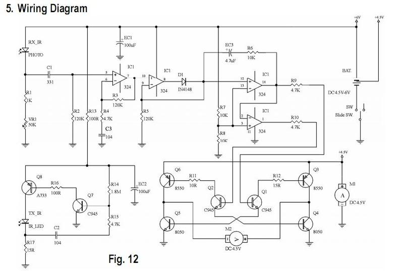

first of all, congratulations. i find it amazing that your nine-year-old has been able to understand any aspect of the ladybug robot kit, even if he has trouble with some of the pronunciation.
unfortunately for me, however, i am not at all gifted with electronics. i am in year 12 and have recently made the same ladybug robot and am required to explain exactly how it works. i understand most of the components individually, but it would be great if someone could give me a step-by-step based on the attached circuit diagram.
my robot doesn't work by the way - only the right-hand motor turns :S this isn't overly important, however, as long as i can explain what went wrong!
i really want to stay top of my physics class because we have less than a month left of school and this is what it all comes down to... please help!!
bridget
forgot to attach the diagram... here it is
oops! hopefully it's attached...

This is what I think it is.
The Q7 and Q8 and the cirucitry around it form a flashing circuit.
How it works:
When voltage is applied a RC timing circuit is set up using R17, R15, C2, R14.
Electron current flows from ground through these components and builds up a neg. voltage at the base of Q7 (NPN) causing Q7 to shut down, for a time denoted by the timing circuit.
That's why R14 is so large to allow a C2 current to build up quickly at the base of Q7. If this resistor was to small then the Q7 would conduct quicker not allowing the capacitor (C2) to fully charge into it's base.
The reasom for that is because now Q8 would be conducting, so current through C2 could be next to nothing, which in turn would stop the flashing process from happening.
Thereby the LED would be dimly on, or fully on depending how much Q8 is conducting.
Another reason for R14 so large is there is no base to ground resistor voltage divider to put at the base, the base is effectively floating.
When the C2 begins to charge to the point where less current flows through it, then the base of Q7, will begin to raise positive, thereby conducting and sending a neg. going signal into the base of Q8, (PNP) which will turn on this transistor causing it to allow current to be dumped quickly through the LED through Q8, the LED flahes on,
But now C2 is being discharged, to the point where current can begin to flow through the RC timing circuiot again shutting down Q7 which in turn shuts down Q8. Now the LED is off again until C2 is charged to the value it was before, starting the whole process over continuously.
If C2 were connected to ground, then there would be no way to discharge the capacitor, but by placing it at the junction of R17 and the LED load then it has a way to discharge for another cycle to begin.
EC2 and R13 is used as a supply decoupling, network, this keeps the oscilator from feeding oscilating currents back into the battery. That's why R13 is so low so as to not have a great effect on the voltage at the base or emitter of Q7 and Q8, but just enough influence to keep isolation between this circuit structure and the rest of the circuitry, which all use the same common battery source.
R17 is mostly low so to be used as a current limiting resistor for the LED.
The LED itself is an IR, so this is probably being used for obsticle avoidance. (I'm just guessing NOW)

Q1 - Q6 and its circuitry form a motor driving H-Bridge.
How it works:
First motor M1 is continually running, (and running forward) because its connected directly across the supply. I don't know why, but that's what the schem. shows.
Q1 and Q2 are the Base drives to turn on the proper combination of transistor Q3 -Q6, which gives the forward and reverse drive of the motor. (M2).
A positive sig. into Q1 will drive a pos. sig. into Q5. Q5 will drive neg. current through M2 neg. term. and current (electron) will flow the path through M2 and the collector emitter of Q3, to supply voltage.
Now at this point M2 is forward running.
Now if a signal on Q1 is off and a sig. (pos) comes to Q2, then the emitter of Q2 will drive pos. voltage into the base of Q4, so now Q4 turns on and drives electron current through the pos. term. of M2 making it run in reverse, and the electron current continues the path through Q6 collector , emitter, to the supply.
That's an overview.
Electonic component detail:
Pos. voltage signal to the base of Q1,would need to be greater than around 1.4v. Because it's base is 1.4v. above ground. Now its collector would be around 3.8v. above ground due to the Vbe of Q3. So a signal into Q1 base will cause Q1 to conduct, the Base current from Q5 will now be Q1's emitter current, this current will flow into the base of the PNP Q3 causing it to conduct.
So now with Q5, conducting and Q3 conducting there is a completed path for electron current to flow through the motor.
That's about it.
THIS IS MY TAKE ON THIS.
If I'm wrong someone will correct it.
I don't know about all the details, but you have a lot of it right.
A more general analysis and explanation:
The lower left side of the circuit is the amplifier and oscillator for the IR LED. I havn't bothered to work out the frequency.
The upper left side is the RX light sensitive diode with a sensitivity adjustment at VR1.
The next stage to the right is the two stage operational amplifier which amplifes the sensor signal and biases it for the next stage. D1 rectifies the signal for the comparitor circuit.
After D1, the sensor signal is fed to a comparitor which sets against a reference voltage, the threshold of which tells the robot it has encountered an obstacle. This is the logic/decision making part of the circuit.
The output of the comparitors drives one set of the robots legs via the H-bridge at the lower right (6 transistors)
The other motor is constantly driven forward.
One comparitor goes high, the other low, sets the motor driven forward by applying the voltage in one direction. This would be when the detector is not sensing an obstacle.
When an obstacle is encountered, the comparitors both change states, applying a reverse voltage to the motor and one side of the robot starts backing up, while the other motor remains forward driving (as it always does). As you can imagine, this causes the robot to turn as it backs up.
When the obstacle is cleared, the comparitor returns to its normal state, and both motors go back to forward movement, until another obstacle is encountered and the cycle repeats.

Thankyou so much!
Your explanation has helped impove my understanding to no end, I can finally get on with my last ever physics assignment and I'm thinking now I might just ace it XD
