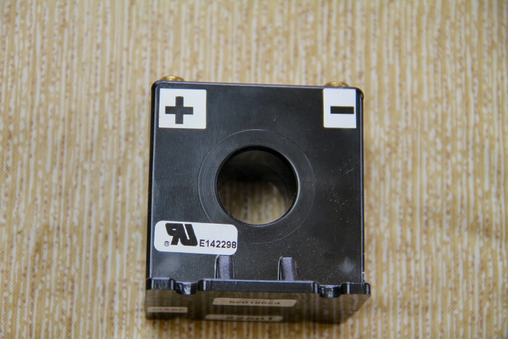

OK, we will look at a few pictures of what I am getting at here, therefore three images are attached for your viewing pleasure. :)

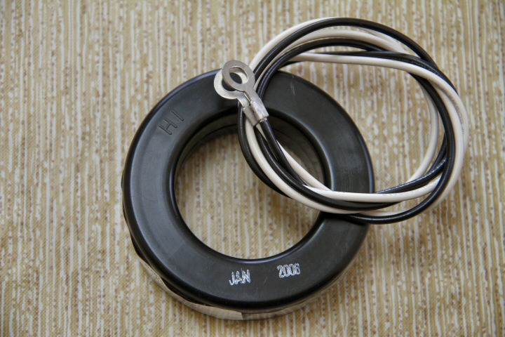

The first image is that of an everyday CT (Current Transformer) compliments of my kitchen table. Lets assume (since you can't see otherwise) that it is a 1,000:5 CT. Therefore 0 to 1,000 amps = 0 to 5 amps. I am sure you have a handle on that.
The next device pictured is a nice current transducer very similar to the CT but this device is a 0 to 20 amp device that provides a DC output. There were some such devices linked to earlier in the thread. These current transducers are powered in a 24 VDC current loop where full scale out is 20 mA or in this case 0 to 20 amps = 4 to 20 mA (4-20 being a very popular current loop).

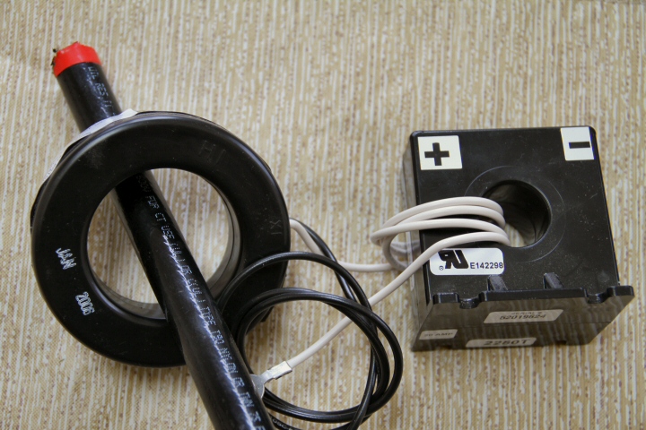

The third picture shows the actual configuration of the two devices. Now something to consider here is that current transformers and current transducers (both our devices) measure current based on amp turns. Now the output from our first CT is 0 to 5 amps, so what I have done on the current transformer, remember the range is 0 to 20 amps is wrap four turns of the primary CT secondary through the second current transducer secondary.
So what we now have3 in our images is 0 to 1000 amps = 0 to 5 amps = 4 to 20 mA in a nice clean DC signal with a good accuracy ratio.
I should point out that the current transducer pictured has a 4 - 20 mA output, however, they can be had with a voltage output. This is simpler and better to drive a comparator circuit. I pictured what I had lying around.
So I take my 4 to 20 mA and run it through a nice precision small 250Ω or 500Ω resistor and get 0 to 1000 amps = either 1 to 5 volts or 2 to 10 volts. Everything is scaled very nice and actually very accurate. I would venture an overall uncertainty of +/- 10 amps at 1000 amps.

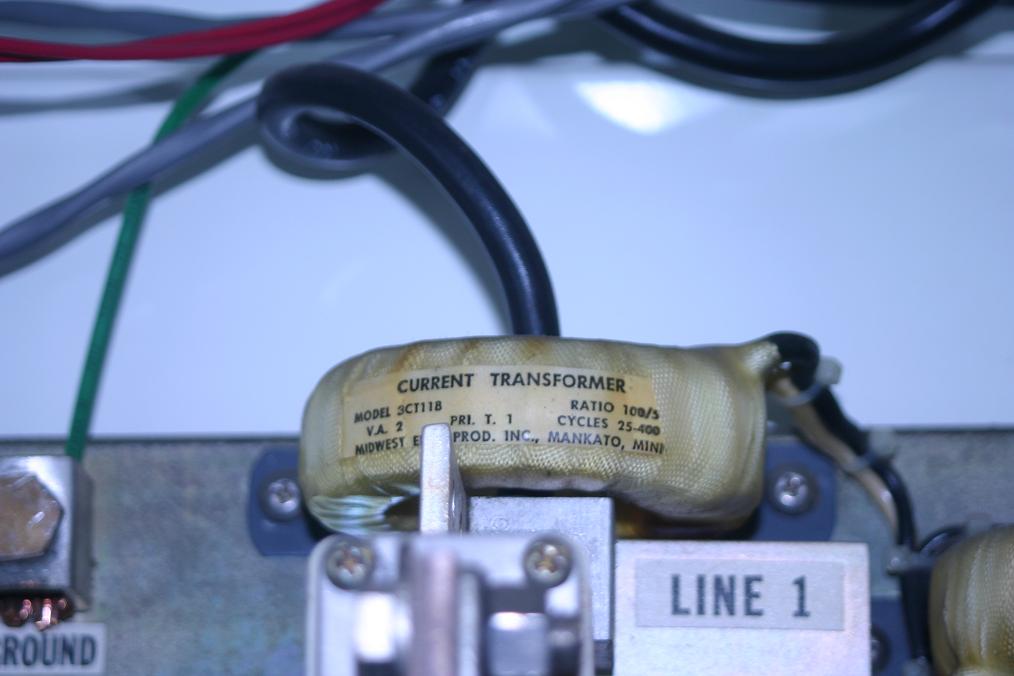

OK, let's look at a few pictures. The first is a CT (Current Transformer) opened up and the second is the CT as normal.
If we look at the CT opened up it is merely a coil wrapped around an iron core. Note the seen wire is the actual secondary of the transformer. The second image shows a cable running through the center of the iron ring (core) and that is the primary. That large current carrying conductor carries the AC current and has a constantly expanding and collapsing magnetic field. The strength of that field is a direct function of the current and is passed on to the secondary turns seen in the first image.
So what we have here is a current (not voltage) ratio in a step down (not up) fashion.
However, there is a caveat to all this. It is very, very unwise to open the secondary of a CT while under a load.
I found a third image in my collection of a mounted working CT. This is a 100:5 CT in a 3 phase 480 VAC circuit I have at work. As you can see there isn't much t it. It simply monitors a phase current sitting there nice and happy. :)
Hope That Helps
Ron

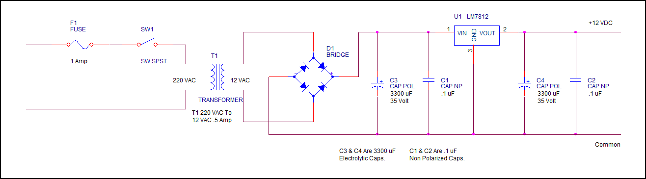

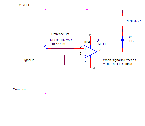

Attached is a LM7812 regulated power supply and an example of a comparator. The signal in is from any signal that is a representation of your current. When the signal in exceeds whatever you set V ref for the LED will light. The LED should be a standard generic LED. Once you know the V fwd and I fwd of the LED you can select the series resistor for the LED.
You will need to condition or whatever the signal from your current probe. Most I have seen output DC Millivolts as in mV per Amp.
As to the NI software you won't find the unit I mentioned. I don't know of any software that would have units like that in the parts library?
Hope the drawings help
