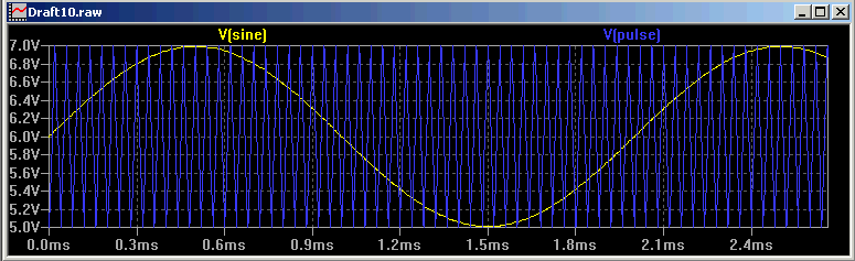

Generating uni-polar PWM signal using IR2113
If I were to use dual supply for op-amps, is it possible to produce a waveform like this?

Why do you want to? For generating PWM don't you need waveforms like this? :-

You don't need output voltages going right to the supply rail voltages to do PWM. Why do you want to?
