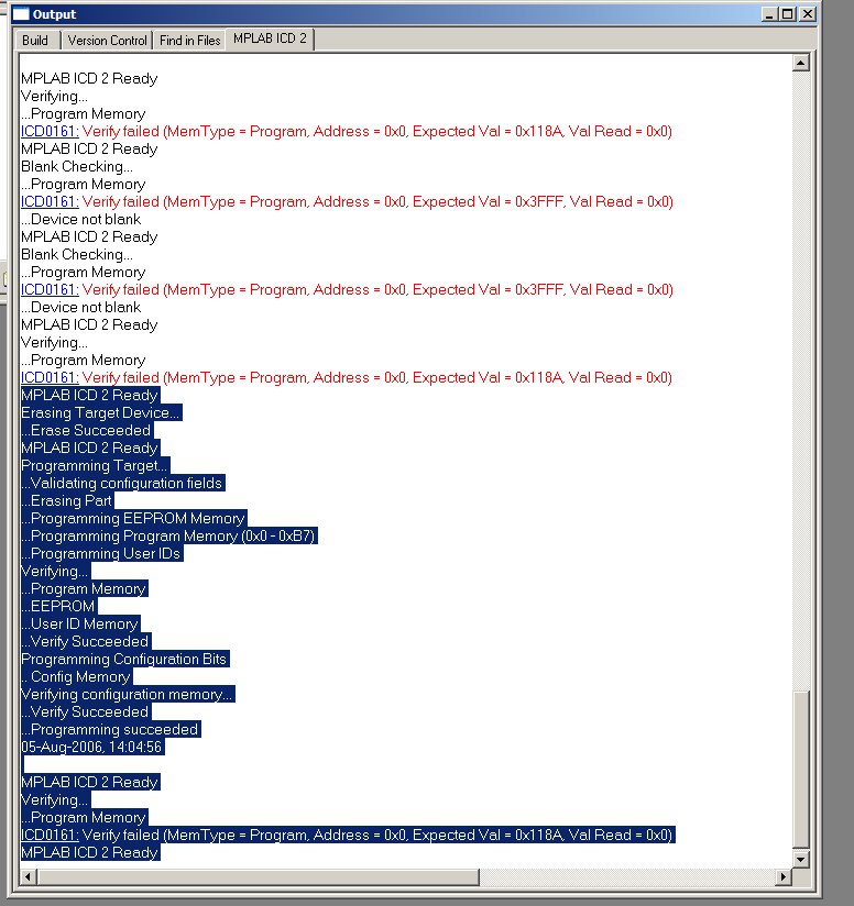

It looks like it will do a program and verify (see thumbnail). But if I hit verify and it fails (assuming that is my build memory against the chip flash)?
If I put the chip in the target it does not work either. I have WDT off, protect off, INTOSC on, etc..
Should a Program/verify, then a verify behind it pass both checks?

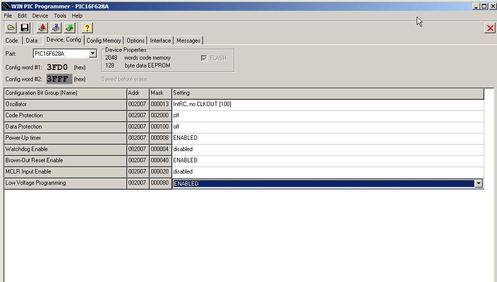

Loaded WinPic and got out the trusty P16PRO40. It will not program it either.
It programs and fails on the verify. This is my first attempt at the 628A.. Here are the settings.. I bought 5 PICs. Maybe I should try another one. Do I need the VPP/MCLR 10K on the P16PRO40 as well for the "A" chips?

BTW: If I hit program over and over it finally takes it. At least you just explained that issue so now I know what is going on far as that....

I see Low Voltage Programming enabled. Don't know about win Pic, but with an ICD2 this will give you problems.
Also, as kchriste said, you should use the !MCLR as !MCLR when using internal osc.
You shouldn't have to give up the other two pins PGC and PGD, just be careful what they are connected to, or jumper them so you can disconnect during programming.

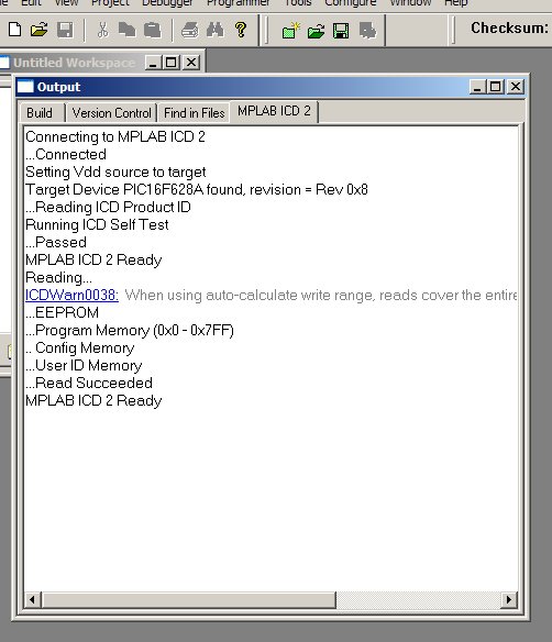

I just hooked it up and did a read. Attached is the screen. But can I ICD with I am using the pins PGC/D are hooked too? I was gonna drop them from the code. I just want to be able to debug to see what the compiler gave me as the code does not work.

BeeBop. I went in programmer and read the chip, then set programmer to none, and selected ICD2 in debugger, hoping it would have the code in a hex buffer somewhere and I could attempt to step through it. Backwards from the norm.. And I get the attached.

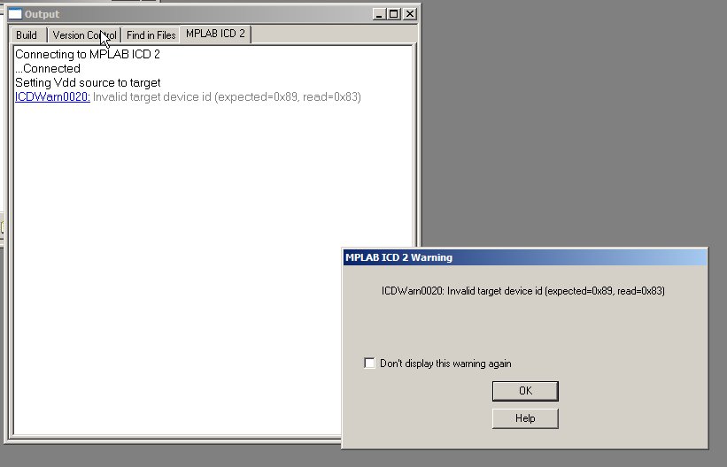

I will tring loading the real ASM and programming again without low voltage and see what I get.. But here is what I get just tring to enter debugger attached to a powered target and ICD2 power jumper off. Mind you I burnt this PIC with Winpic/P16PRO40 not the ICD2, maybe it was looking for config bytes or a bootloader for the ICD.

OK, that second post, the error of not finding the right target, usually comes up when there is a problem on the PGD and or PGC pins. If the error relates to power, it is usually the !MCLR or v+, v- pins which are the culprits. I think I already asked how these are connected, oh wait. Are you just going to program the chip with a clip, or is it in a circuit?
