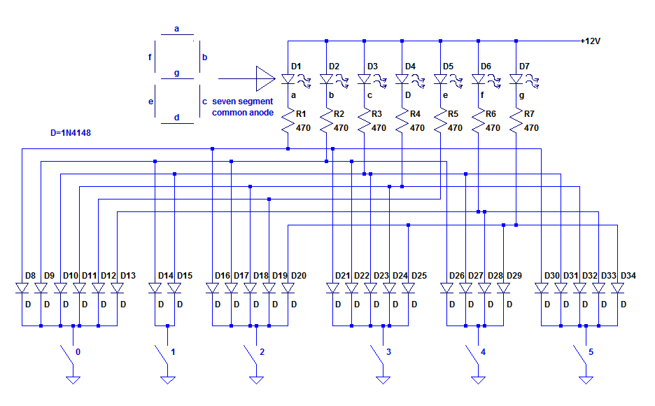

If you don't know how to program a PIC, here is a modification of a circuit I designed for a guy who wanted 0-6. As shown below, it will indicate 0-5. You can change 0 (reverse) to some other character very simply.
You will have to come up with a switch closure for each gear. If you can't do it mechanically (microswitches), it could possibly be done with magnetic sensing (Hall effect devices).

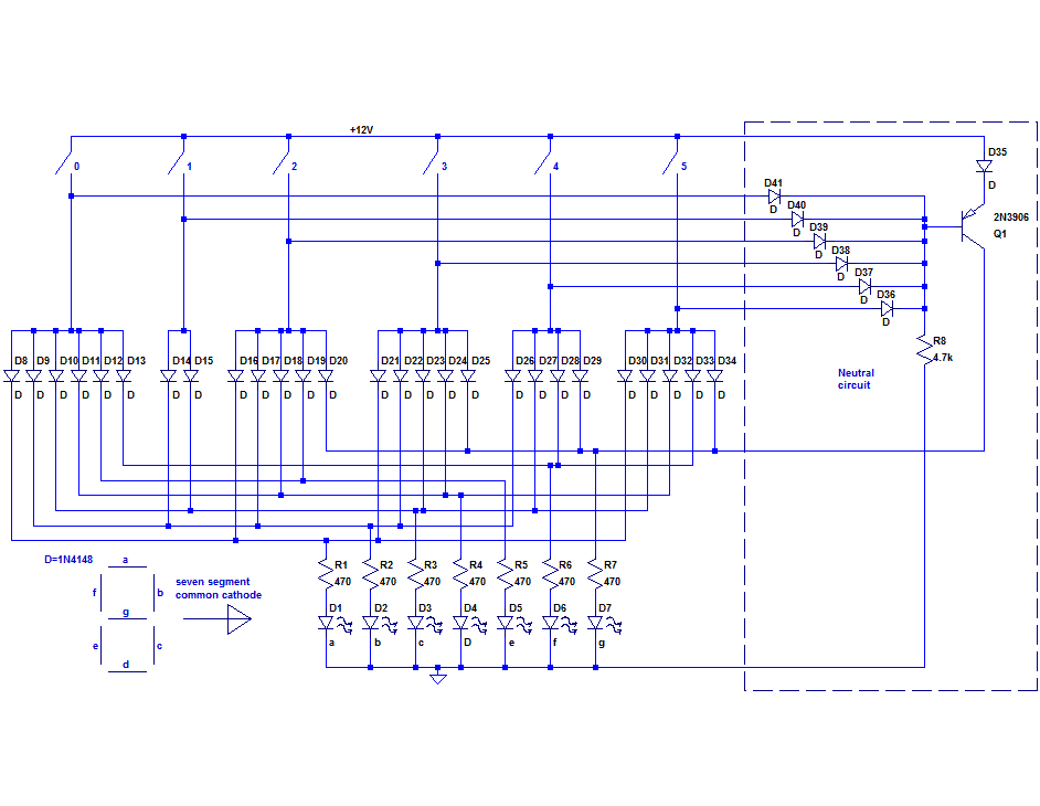

In response to some requests by PM from zx16v, and another PM from yassirau, I am posting another version of the gear indicator. It is far from being a minimum-hardware design, so don't rag on me about the large number of diodes! :D It avoids the need to learn to program a PIC, and, for those who may not have easy access to components, uses a minimum of different component types.
This design uses a common-cathode display, and has indications for 0 (reverse?) through 5, and uses "-" to indicate neutral. The "0" can be changed to some other symbol by changing the connections of a few diodes.
