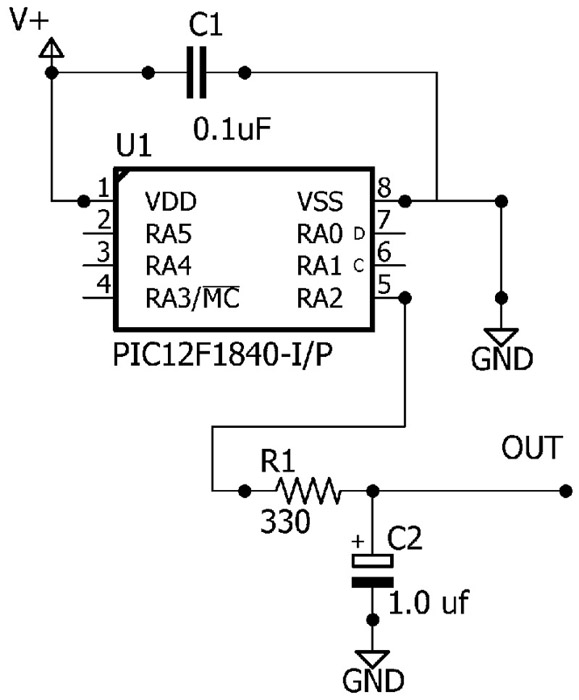

Time for a wave form of my own generation.
This is from a PIC1840, "fake" sinewave that I did some time ago for some reason.
Sweet.
For anybody interested:
This is the schematic:
and the code:

Although I did do the circuit and code, the technique is not at all new or original.
edited: got rid of a bunch of comments in the code

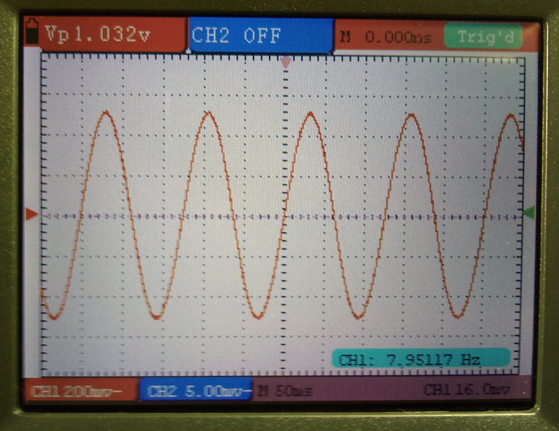

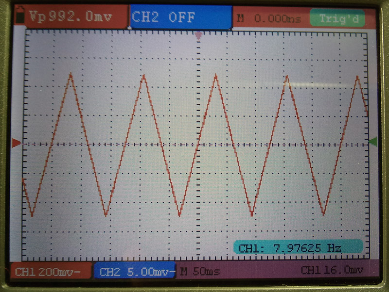

A few waveforms from a very old and discarded (broken) frequency generator that was given to me (and that I actually managed to get functional again).

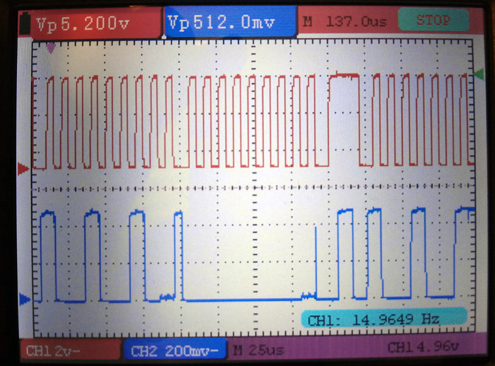

This was one of the "goals", I2C transactions.
SCL on top of SDA. It works, but I think I can get it better. I am fumbling around a lot with the scales and settings and so on.
Some of the better and now even cheaper ones will decode certain buses for you, like I2c.

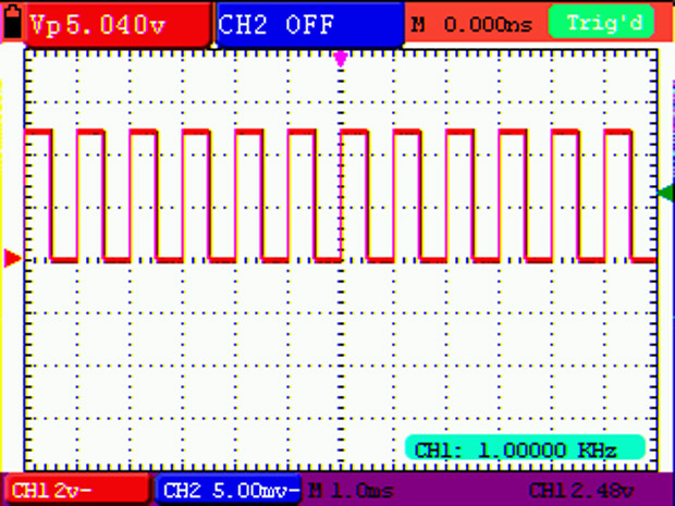

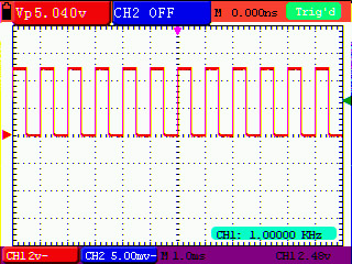

This was my first try at saving the screen using a USB memory stick. Just hit the copy button.
They are small and I don't see any way of changing that. Saves as a BMP or Vector file. Above is the .bmp which I converted to a .jpg.
.bmps enlarge pretty well, e.g., below.
I don't know, off hand, how to view the .bin Vector files - would need to do some reading on that.
BTW: the 5V, 1KHz waveform above is from the reference brick and I have persistence on, which smoothes/thickens the wave - there are a couple options there.
