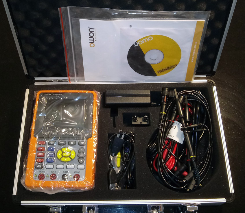

I have a toy O-scope. This one in fact, and I payed that price - maybe it was US$20 at the time (or sale). A semi-kit, it went together well and, it works. I have used it many times over the last few years. As you can tell, it is limited.
So, I was ready for an upgrade. At this point, I could never justify several thousand dollars for a scope. More than the price, I like to adhere to a principle of what is appropriate for one's needs and expertise.
I have been "tracking" various small o-scopes - $200-$500 price range. But didn't decide on anything...until now.
I bought this one - 20MHz, 2-channel. Except, I got it for US$212 and free shipping at Arrow (I think they are out now, but I did get a confirmation). They had several OWON scopes at ~ half price.
I debated whether to get a single channel 60MHz ($150) or 100 MHz ($170), but decided I wanted two channels and I did not have the option of faster 2 channel ones on sale.
My thinking, rightly or wrongly, is that two channels would be particularly useful for interface work (like I2C).
I will see, but I think I did ok and I do like my toys.
What do you think - CCJ (cheap chinese junk) or legitimate beginner's tool, or both.

Well, the Chinese certainly know how to make cheap tat, mainly because that is what we (the west) ask them to make.
On the other hand they know how to make some reasonable stuff at a keen price to suit the keen amateur experimenter.
Two channels is usually a better choice over single channel, but 20MHz bandwidth may be a bit limiting sometimes. but certainly beats no scope at all, and if it is what fits your budget then that is what you get.

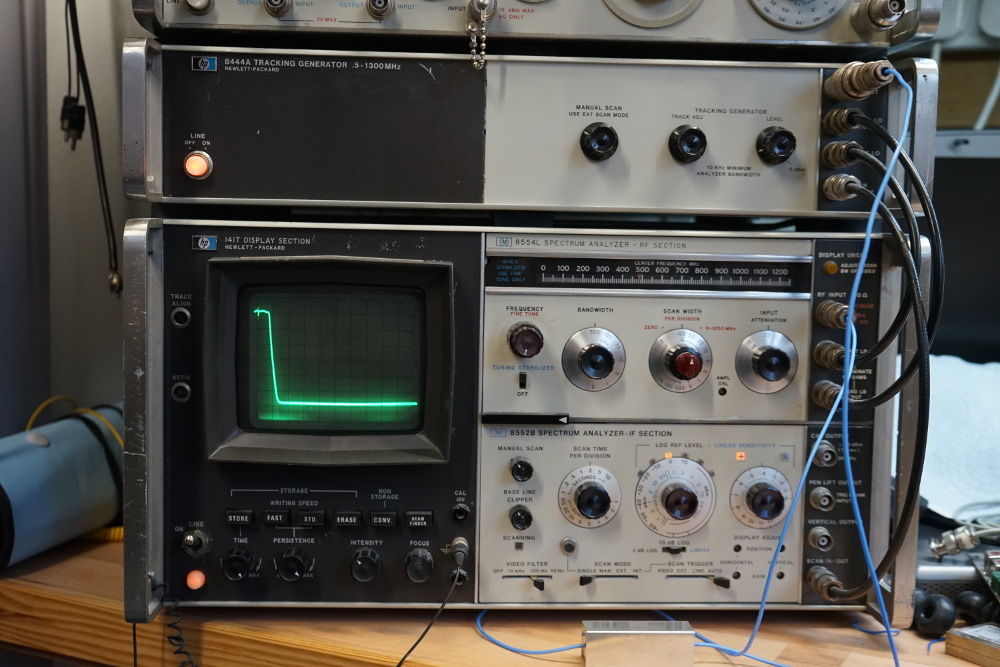

Earlier this year I decided to buy myself a nice big birthday present and replace my ageing spectrum analyser.
Olden but golden, 30 going on 40 years old, and a lot has changed in those years. No I did not buy it new, it was about 20+ years old when I got it.
A new replacement would have to come from the far east, would it be any good?

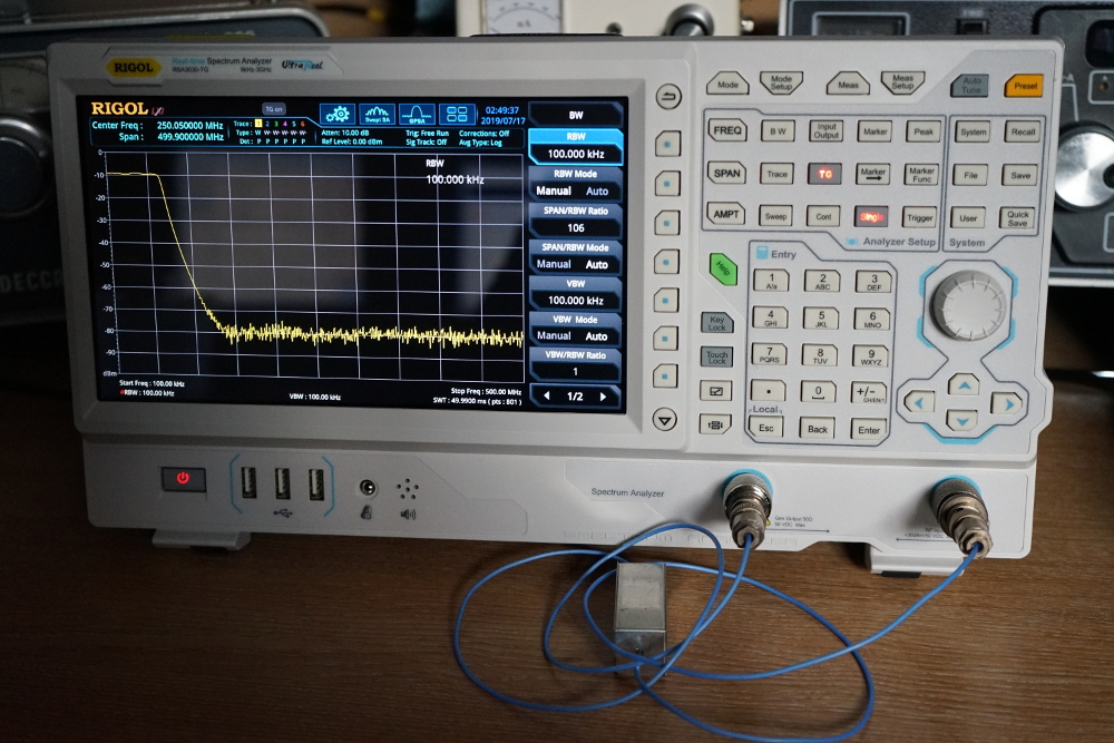

So with great trepidation I bought this:
Quite coincidentally, both pictures show the frequency response of the same 60MHz lowpass filter (the little tinplate box).
Do I have any regrets buying a Chinese spectrum analyser?
None whatsoever.
It is a delight to use, somethings about it seem a bit quirky after the old one, but that is just progress I guess.
And the new owner of my old analyser is very happy with it.
So, enjoy your new scope when it arrives and let us know what you think about it.
Will do, thanks. Now though, I am wondering whether I will get it in the end. While I received an order confirmation as I mentioned, I do not see the inventory updating online. I am preparing for a disappointment email tomorrow, but I shall see.

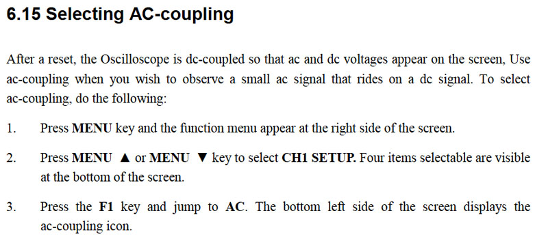

Looks Ok,
Can you Ac couple the i/p, some you cannot.

Well, I did not get a "Bah Humbug" email today, but instead, I got a tracking number (yay). Should be here tomorrow with a little luck. I am excited!
I really wanted a small/portable unit. The only thing that I see that is missing is a lipo (~US$35) - of course it includes an adapter.
https://images-na.ssl-images-amazon.com/images/I/91d4qyrrL5L._SL1500_.jpg
Plus, it comes with a cool little aluminum nerd case.
This model, while not new, is being sold all over and is frequently priced at twice what I payed. Arrow was running a big time sale. This came to my attention from an eevblog thread. There was a lot of hubub about $188 for the XDS3202E and other items. Many were already sold out when I got there and the one I bought has sold out as well,
The timing and the price were right. I'll find out (and it will take me a while to start playing), but right now, I am [mildly] excited.

Looks Ok,

Tah-Dah!
Have only finished the Quick Start guide and browsed the manual. I plan on doing some testing tomorrow (and BTW it does have a battery, don't know what I had looked at earlier).
So far, so good!
It has bnc's as well as bannana's?

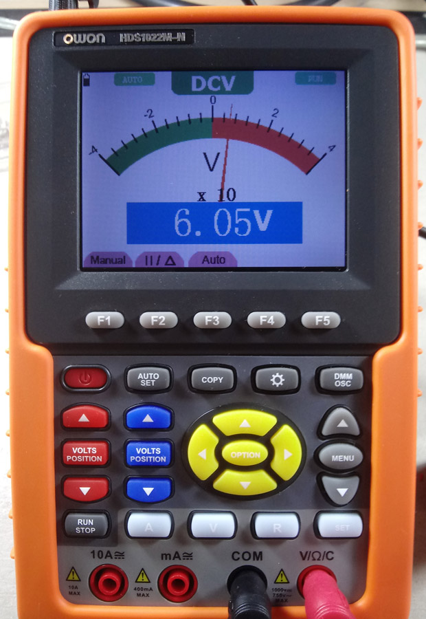

Yeah, it has Multimeter mode (bananas) separate from the Oscilloscope (BNCs) - see the DMM / OSC button? The DMM has all the regular stuff, including diode and capacitance testing. Auto-ranging or manual. It has a relative measurement that I am not quite certain of yet - "A currently measured result relative to the defined reference value is displayed in a relative measurement".

Having finished a tour of the Multimeter (with component testing), it is time to move on to the main feature - Oscilloscope.

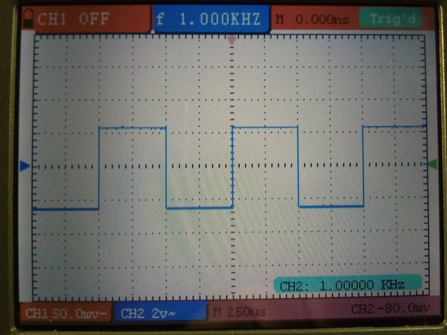

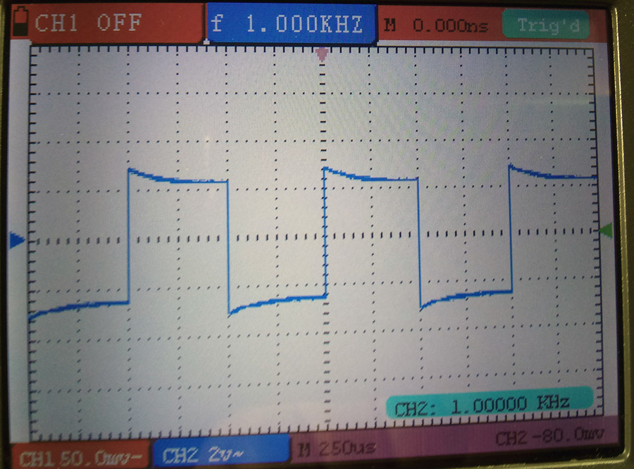

Frequency compensation accomplished. These quick phone pics were not, "as it happened / before and after", I am fiddling with the variable capacitor on the probe to make sure I am following the process correctly. Edited to add: That is a 5V 1.0 KHz reference that is provided as a plug-in brick.
