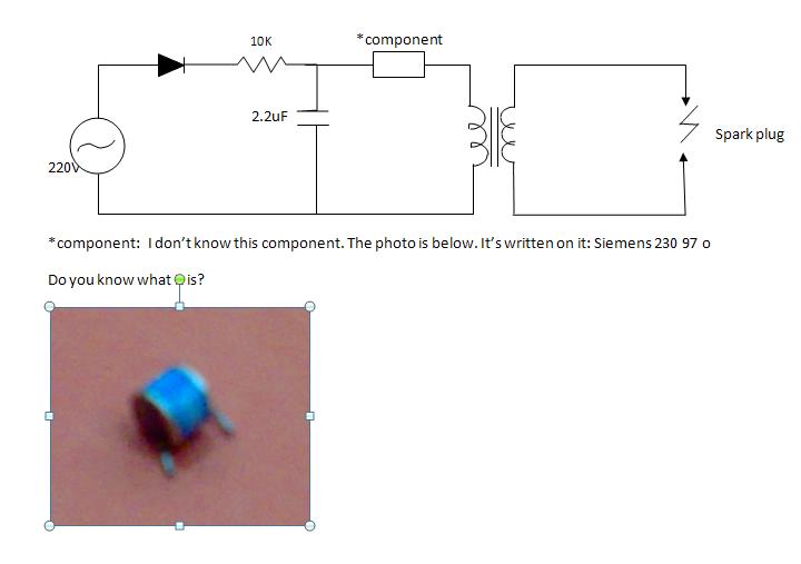

That's right. Attached is a Capasitor discharge ignitor. Could anyone explain me how figure 1 and figure 2 work( before and after triggering).
I 've also found a gas stove spark kit in the market. Please see the attached file "spark". Please also help me recognize the unknown component in it.

I would imagine it's some kind of discharge device?, as the 2.2uF charges up it's threshold voltage will be reached, discharging the 2.2uF into the transformer. It could be a high power diac?.
It's probably a gas discharge tube, it's basically a spark gap in an inert atmosphere.
Hero999 is correct.
Similar devices are also used in telephone circuits to clamp spikes on the phone line.

When the voltage on the transformer's primary changes quickly and there is no load at all on the output, the output voltage is very high, almost unlimited. But once the voltage rises high enough the spark gap breaks down and loads the output. Hopefully the high temp of the spark will ignite the flame.
The circuit is designed for repeat sparks. Once the switching "Component" there conducts, it drains the cap and makes a current spike on the primary. Once it's drained the switch turns off, the resistor starts charging the cap again, but the switch is designed not to conduct until the cap is fully charged again.
