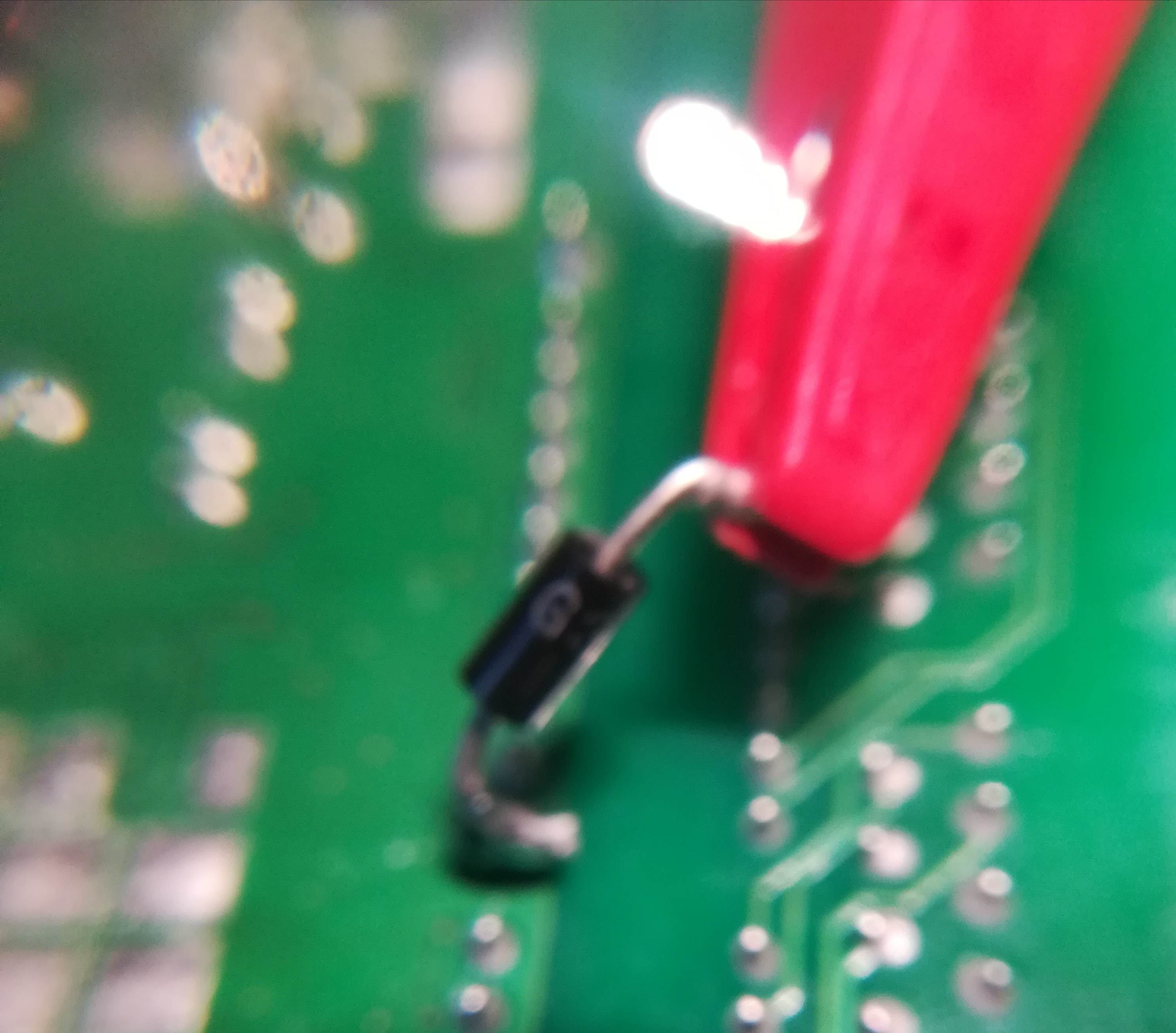

G35LA I208 diode?
lynx
Hi
a G35LA 208I in the RJ11
port of a router what can it be? the pad says D1 the component looks like
a diode (as seen in the photo) but i cant find that code, also reads infinite resistance both sides
you are right... since its parallel with the rj11 pins.
I'm trying to troubleshot syncronization problems with this router everything works perfect i couldnt find any problems with the interface other routers work but this stopped few days ago.
Well it's not going to be that, and it has no effect on the router operation, just a safety device.
