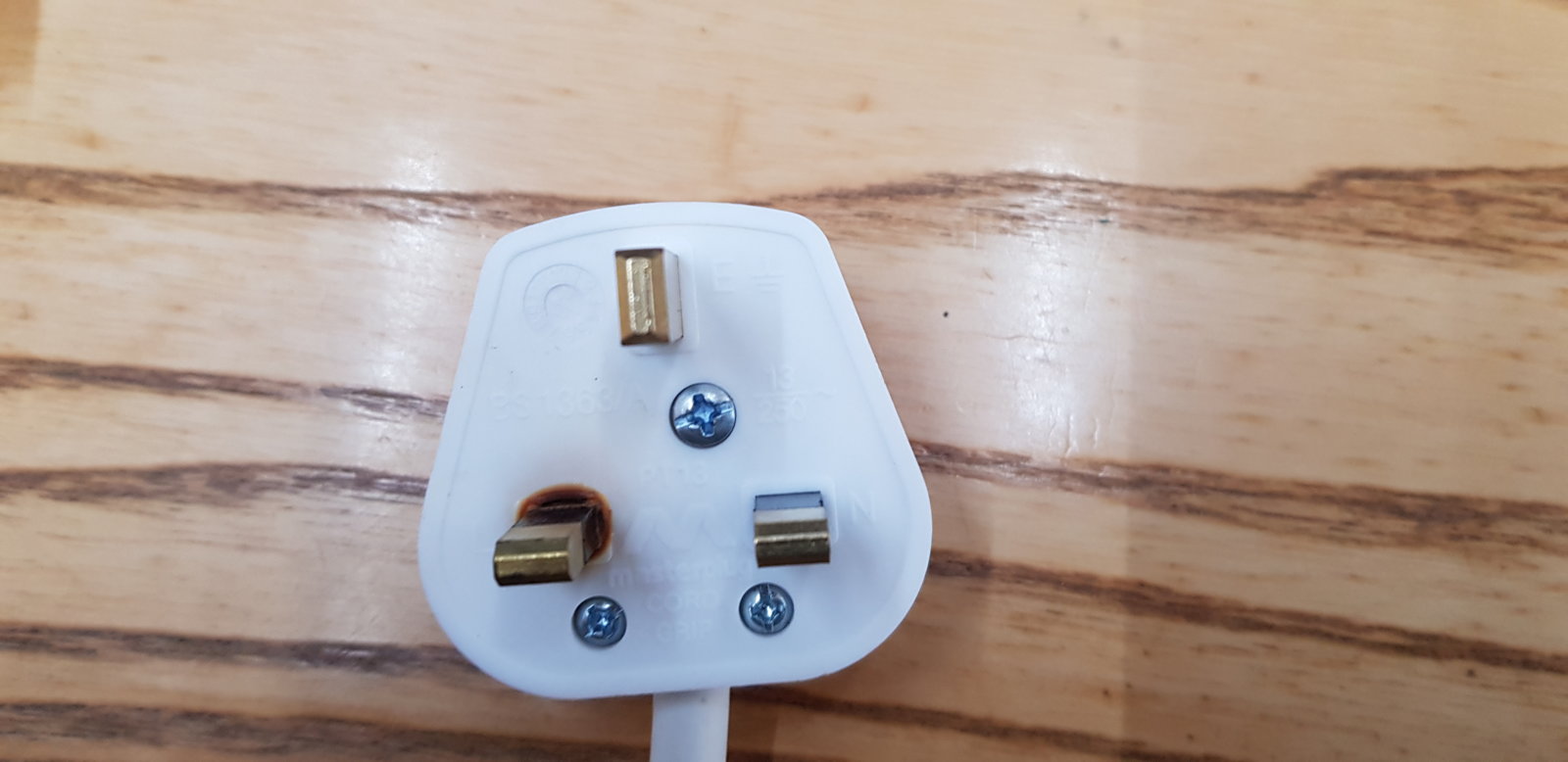

Yes, it's normal. In the UK they placed fuses in 13A plugs. If you use something like an electric heater, the live pin of the plug gets so hot that the colour of the plastic surround goes brown (yellow?).
Like this,
The fuse is connected to the end of the burnt leg.
A fuse will always get warm if run near it's rating. The rest depends on the quality of the connector.
There shouldn't be any burning on a 13 A plug like Pommie showed, so I would have said that was a faulty one, but of course the same plug would have been fine on most loads. UK plugs will usually take 13 A / 3 kW continually without burning, but the plug will be warm as the fuse will heat up.
Not lived in the UK for 20 years but remember well the brown ring on the live pin of the 13A plugs. Check your kettle lead/plug as they run close to 13A.

13A plugs shouldn't (and don't) do that - if they do the plug was badly fitted, or the fuse 'clamps' were loose, making a poor contact on the fuse. Or, the socket it plugged in to had loose contacts, and the heat transferred up the pin.
If a plug ever goes like that, replace it - if it's because the fuse 'clamps' were loose the metal of the clamp will have been 'de-tempered', and even if you squeeze it to make it tight again it will tend to loosen off and overheat again.
