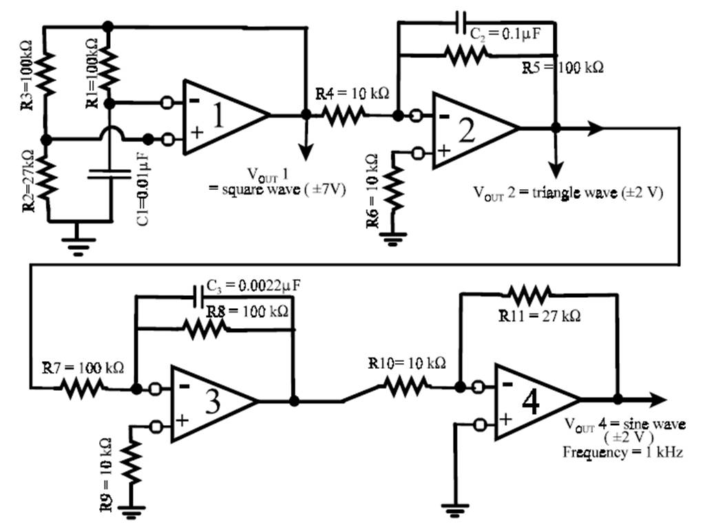

hi.. can you help me to vary the frequency in this schematic?? i need to have a range of frequency of 6Hz-7 kHz.. urgent reply..please... thanks..

R1 and C1 set the frequency for the square-wave. Then the integrators filter out some of the harmonics and make a triangle and sort-of sine-wave.
The capacitors must be non-polarized but for your extremely low frequency they will be huge unless you use two electrolytic capacitors back-to-back for each one.
Even though the mulivibrator section can be varied in frequency as AudioGuru said, the filters which are intended to make puesdo sine wave are fix-tuned to one specific frequency, and will not work over three decades. If you need a sine waves, you should be looking at an intrinsically sine-wave oscillator, like a Wien-Bridge.
In fact, nothing after amp1 will work over the frequency range. Even the square gen, amp1, isn't configured correctly. There are good function gen. circuits, where all the signals work.

I agree, except for the fact that the AGC loop will take a long time to settle when the frequency is low. Direct digital synthesis is the clean way to do it, but is more complex. A function generator with a sine shaper , e.g., XR2206 is another way. Still another method uses a switched capacitor filter.
Agree with the previous posters.
Your circuit is only really suitable for operation at one particular frequency, or over a very narrow frequency range as it now is.
If you want to generate sine, square, and triangle waves over a very wide frequency range, use a commercial function generator chip such as the one Roff has already suggested.
These are low cost, very easy to use, and work well.

just wondering of what audioguru said.. what do you mean of using 2 electrolytic capacitors back to back?? do i need to make it in series??
my main priority is to be build a function generator using 741 op-amp..

i only have this schematic for 741 function generator... will i change the R1 to a potentiometer to vary the frequency??

Two polarized electrolytic capacitors in series and back-to-back make a non-polarized capacitor with half the value of one.
Your extremely old and simple circuit makes a poor sine-wave with a single frequency. You might make it switch parts for other frequencies. Three capacitors and/or three resistors must be changed at the same time.
The 741 opamp is too old and slow to make high frequencies.

i've thinking of changing the R1 with a pot..and apply the 2 electrolytic in series like what you've said..
what do you mean by switching parts and what are those capacitors and resistors to change each time??

Yes, all those components ALL need to be changed when you change the frequency.
If you don't you will have massive changes of output amplitude and wave shape as you try to change frequency.
If you do not vary the filters the same as the oscillator then the "sine-wave" will turn into a poor square-wave or its amplitude will be reduced.
