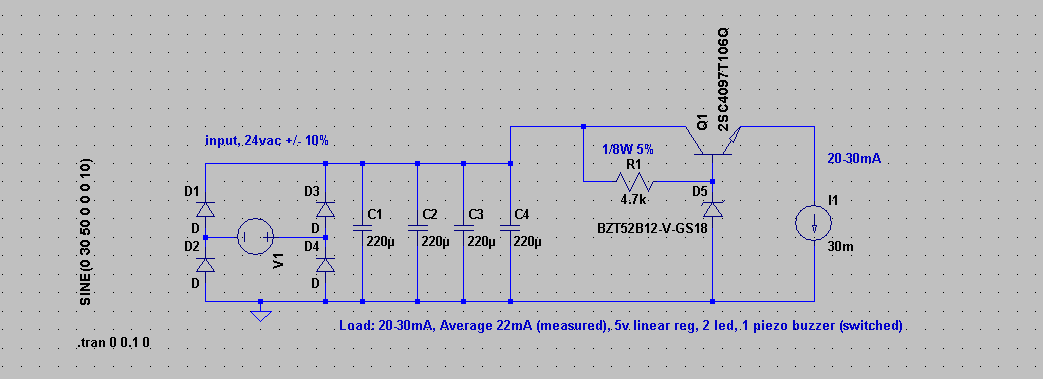

I built up the circuit, and it works. 68V 220uF caps, and I was actually able to squeeze 4 of them across the back of the pcb. I learned that I am horrible at estimating current draw, as a measurement on the output of my buck regulator yeilded a 12V draw of only 22mA. While I may be able to reduce the capacitance or number of caps at this point, I'm going to choose not to. I would like some further help with specifiying components for the regulator portion as I now plan to try an emitter follower voltage regulator to save space / cost and complexity associated with that switcher i'm using now. attached is my schematic an proposed part numbers. I would welcome criticism and / or reinforcement before i try this and let the magic smoke out because of something i missed.

The problem with a linear regulator is that the extra power gets dissipated in the transistor. So in your case 21 volts X .03 amps = .6 watts so it will want to be a TO220 package (temperature rise of 62C/watt) or something with a heatsink. You might look at an LM317HV as a solution or maybe a 12 volt transformer instead of the 24 volt one, then a little TL750L would probably just work and be better regulated and protected.
I'm not providing the transformer. My input is 24VAC. I'm going to test an IFX25001TC V10 and see how loud the piezo is at 10V. Thanks for catching that power dissipation problem. Saved me a meltdown.
