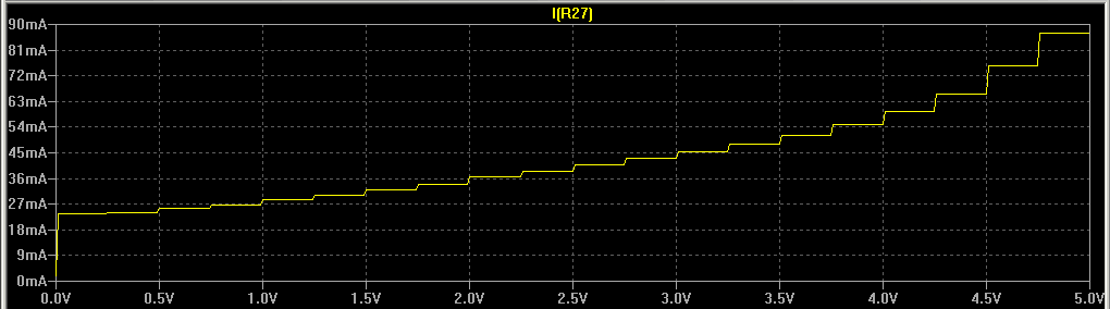

Here's a 20-step version, using 2 x LM3194. To simplify the spice models I made them specific to this application.

Wow, thanks. That looks great. Much more accurate between 50% and 100% than it could have been with each step limited to 20 mA max. Now I'm glad that I didn't spend all day at work laying out a PCB design for the single-chip solution. :)
It's just occurred to me that the model is based on the assumption that the gauge supply is a fixed 12V. Is the gauge supply the same as the battery you are monitoring? If so, what battery voltage can we take as 'empty' and what as 'full'? The model resistors will need adjusting to cater for a varying gauge supply voltage.

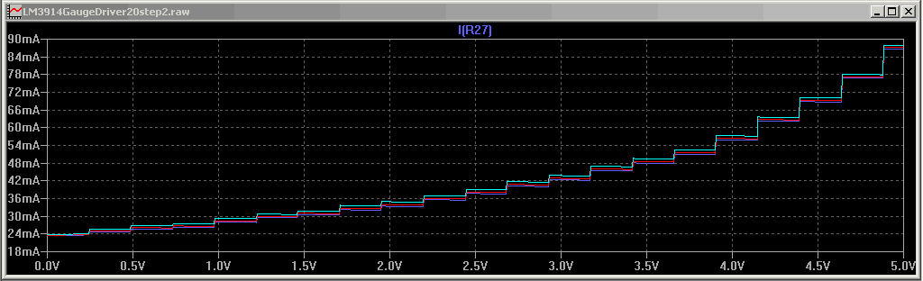

I've remodelled things assuming the input source goes from 0V to 5V as the '12V' bus goes from 10.5V to 13.5V. I've also added a current amplifier (Q1-Q3) to reduce power consumption drastically. Each LM3914 output now sinks only ~ 1.25mA (instead of ~22mA previously). This in turn means that the ICs can run from the 12V bus without getting hot and the 5V regulator is no longer needed.
R4 may need tweaking so that the input voltage on IC pin 5 is a tad over 2.5V when the source is 5V.
R5 is fairly critical to define the first step up the curve.
R28 sets the current-amp gain to define the output span.
R30 sets the 'empty' current at 24mA.
Not shown on the schematic are essential decoupling capacitors for the IC supply pins.
The graphs are the overlapped curves for the circuit response at 10C intervals from -20C to +60C and show that there should now be negligible temperature drift.
Is the "R27" current now impervious to transient flucuations within that range, or are you saying that what's shown on the graph is dependent upon the supply voltage being 10.5 V @ empty, 12.0 V at 50%, and 13.5 V at 100% state of charge?
What are the implications if R4 isn't adequately tweaked to produce that exact voltage?
What do I need in the way of capacitors, and what nodes should they be attached to?
Thanks.
Yes. The model uses the equation Vsupply = 10.5 + 0.6 * Vsource.
Step 1 may be at the same level as step 0 (i.e.24mA), or slightly shifted along the x-axis.
The datasheet recommends 10uF tantalum or 22uF otherwise, connected as close as possible to the chip supply pins (2,3).

Can we assume then, for modelling purposes, that the gauge supply drops uniformly from 12.7V to 11.5V, while the monitor (source) drops from 100% to 0%, going from 'full' to empty'? Or do you have an alternative suggestion?
Couldn't find any useful info on the 933.
That's probably the best assumption we can make. Although I'd go with 12.5 V as the starting point; that's probably the best average amongst different brands of batteries, and 12.7 is especially unlikely as the batteries age, and at temperatures < 30 deg C (i.e. most of the year). And I think I'd rather err on the side of reading off-scale vs. underreporting a fully charged battery (which could lead to overcharging).
I've run the sim with a 12.5 to 11.5 supply voltage range and by changing R28 and R30 slightly (to 4k8 and 3k9 respectively) the resulting curve is practically the same as previously. If those two resistors are trimmers you should be able to cater for all component/battery tolerances simply.
What started out as a '1 transistor + 4 resistors' circuit seems to have grown somewhat, but I think we're near the finish line now. Merry Christmas!
