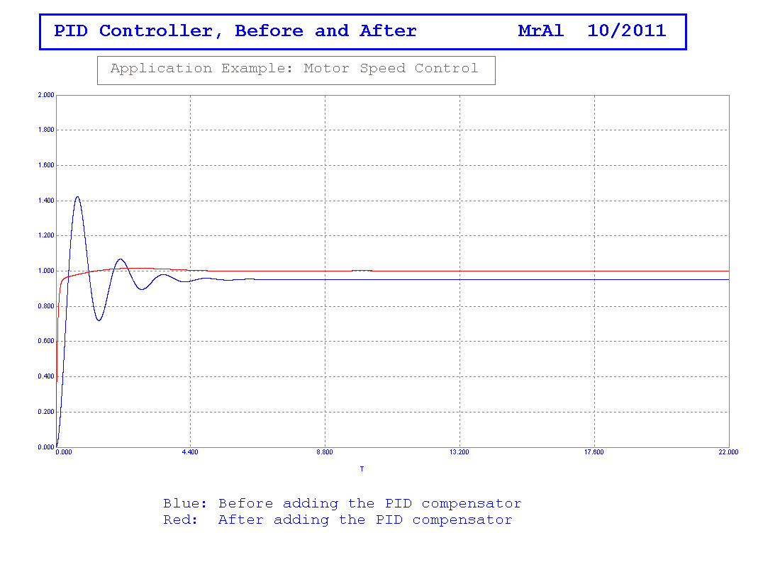

Hi again,
The integrator circuit really does increase the steady state accuracy. With a perfect integrator you'd get 1.000 out for 1.000 in. With the integrator only with nothing else, you'd get the perfect accuracy but the response would be ringing until it stabilized. This may not be a problem in some systems but with the added P and D we can get a much nicer output.
If you look at the attachment it shows two waveforms for a motor speed control. The blue wave is for the uncompensated system where you can see not only an oscillation before it settles but also a steady state error of about 5 percent. The red wave shows the speed response after the PID controller is inserted into the feed forward path. You can see we got a much nicer response now. Not only did we get rid of lots of oscillation, we also got rid of the steady state error which would be very low now.
The waveform without the P and D added (only I) comes out with a near zero steady state error, but there is still oscillation. Adding all three and we get a nice output as shown in red.

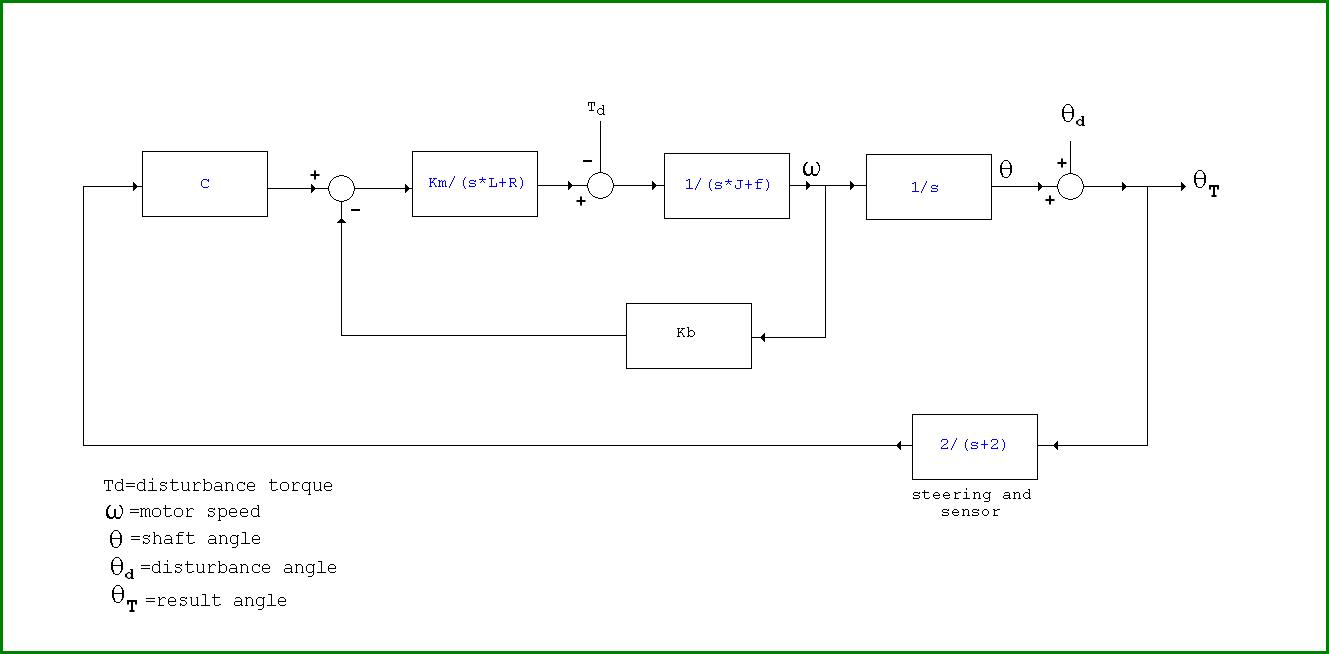

If we want to design a line follower robot using PID controller ...how can we go with it??
and Thanks for writing big reply but it was difficult to understand.
I've included a quick diagram of a system we can look at. The sensor for this system would be two LDR's wired in series and two LEDs, with a positive reference voltage to the top LDR and a negative reference voltage to the bottom LDR so that when the car goes off the line one LDR increases in resistance and the other LDR decreases in resistance and that provides us with an error signal for the feedback.
For this discussion i'll use:
w for motor speed
O for shaft angle
Od for disturbance torque
OT for result angle
and the following values:
Km=10
L=0.1
R=0.1
J=2
f=10
Steering and Sensor=2/(s+2)
C=controller
The result angle OT is the angle of the car which is zero when the car is properly
following the line. If the car drifts to the right or left the angle changes and
appears as a disturbance angle Od. The result angle OT then changes and it is
the job of the feedback to adjust the angle of the motor shaft O so that the
result angle again goes back to zero.
The system as shown in the diagram is unstable when the controller network C is equal to 1 (which is no compensator at all) so we design a controller to stabilize the system.

But i can't able to understand that equation in att. file( figure).

Which equation is that? Inside the blocks or the whole equation for the system, or something else?
