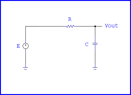

Friend had a small problem with something i built a long time ago too today so i had to go over and fix that. Something broke so it had to be recalibrated.
We can start with:
[LATEX]\boldsymbol{\dot{x}}=A \vec{\boldsymbol{x}}+B \vec{\boldsymbol{u}}[/LATEX]
For the circuit shown in the attachment, we have:
A=-1/RC, and
B=1/RC, and
u=E, and so we have:
[LATEX]\boldsymbol{\dot{x}}=A \boldsymbol{x}+B \boldsymbol{u} [/LATEX]
[LATEX]\boldsymbol{\dot{x}}=\frac{-1}{RC}\boldsymbol{x} + \frac{1}{RC}E[/LATEX]
Next, we'll look at the form of the transform to move into the frequency domain directly from the state vector differential equation.
To get into the frequency domain we can use this form:
[LATEX]
\boldsymbol{X}(s)=(s \boldsymbol{I}-\boldsymbol{A})^{-1} \boldsymbol{B}\boldsymbol{u}
[/LATEX]
where
[LATEX] \boldsymbol{I}[/LATEX] is the identity matrix of the same order as the system,
[LATEX] \boldsymbol{A}\ and\ \boldsymbol{B} [/LATEX] are the same matrices as previously described.
With A equal to [-1/RC] and B equal to [1/RC] the order of the system is 1, so the identity matrix of this system is simply [1]. This gives us:
[LATEX]\boldsymbol{X}(s)=(s*1-(\frac{-1}{RC}))^{-1} *\frac{1}{RC}E = (s+\frac{1}{RC})^{-1}*\frac{E}{RC} [/LATEX]
Since the inverse of s+1/RC is RC/(s*RC+1), we have:
[LATEX]\boldsymbol{X}(s)=(s+\frac{1}{RC})^{-1}*\frac{E}{RC} = (\frac{RC}{s*RC+1})*\frac{E}{RC} = \frac{E}{s*RC+1}[/LATEX]
So the frequency domain representation of the state equation is:
[LATEX]\boldsymbol{X}(s)=\frac{E}{s*RC+1}[/LATEX]
Question: How does this result compare with a straight up AC analysis of the circuit in the attachment?
Answer: Rest assured, it is *exactly* the same.

Hi again sir,
The example can be solved with transfer function also but why to use Sate variable equation ? as i know we use Sate variable equation for MIMO
Can you tell me about matrix D..??
Hello again,
You posted a question about the state equations so that's why i made the example like that.
