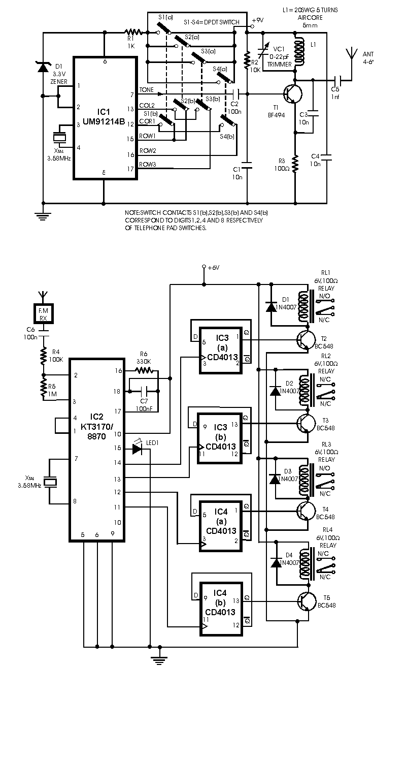

I am wondering to make a radio remote control project which has 10 ways. But, I am just a newbie on electronics. Please provide me some information regarding on my project. I appreciate on any bit of info or link related to my project.

10 ways means, to control 10 relays via the remote control.
I want that to make a remote control car. So, I want Forward, Backward, Left, Right, Back Light, Forward Light, Left and Right signals and much more. So I need 10 way RF Radio control circuit.

Even im working on the same project.
The cicuit below should give a clear idea. And it just works fine.
u can get 12 different controls from UM91214 ic as given below
pin nos| 12 13 14
15 | 1 2 3
16 | 4 5 6
17 | 7 8 9
18 | 11 10 12
I dont think you will need that many channels? as left/right should work for fwd or rev. 4 Should do it, giving one channel for stop ;) If its setup for 2 buttons pressed coding.

Sorry, the diagram was not loaded properly last time i mailed u.
here is the diagram with the UM91214 ic with decoder circuit for RF remote.
Believe me it works very well.
