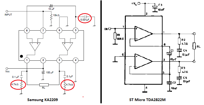

If the noise appears to be a "motor boating" or porpoise-like" pop sound, this instability often comes from a relaxation oscillator effect that may be triggered by high frequency instability. The latter is suppressed by the 4R7+ C loading where you have 10R0. Other variations I have seen of this circuit use 0R or 2R2. The addition of R5 helps to decouple and debug for instability.
Hi Tony, I agree with you that the 10 ohm Zobel network resistors should be 4.7 ohms, I wonder why they were changed from the 4.7 shown on the datasheet?
I think ST Micro goofed because the Zobel networks are on the wrong side of the inductive output capacitors. EVERY audio amplifier IC from National Semi has the Zobels connected directly to the output pins of the IC.
Did you notice that he has a much higher power bridged mono amplifier with tonnes of bass and yours is a lower power stereo amplifier with reduced bass below 91Hz into 8 ohms due to its tiny output capacitors?

I have a little circuit board that came out of something. I took some resistors and capacitors from it over the years. It has a Samsung KA2209 dual power amplifier that seems to be a copy of the ST micro TDA2822M that you are using.
The Koreans or the Italians made a few mistakes on their schematic. I will let you guess which one is correct.
