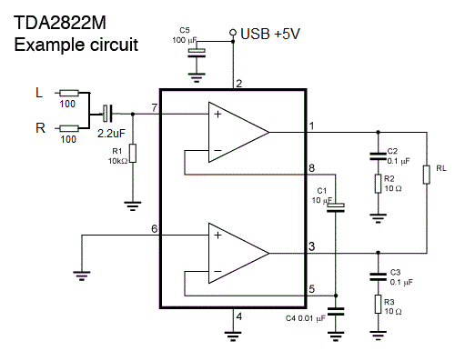

Recently I build an audio amplifier (schematic attached) based on TDA2822 8 pin DIP. But it's generating a kind of loud noise like "TaDat! TaDat!! TaDat!!!......" frequently twice or thrice in a second, almost louder than audio output. +5 volts is supplied by laptop USB and audio source is same laptop's headphone output.
It's amazing that it works so nice if I used same USB supply (from laptop) but my cellphone as audio source. What could be the reason and what can I do for further calibration?
Here's what I made exactly- (attachment)

Check that the earth of the headphones is 0 ohm to the negative of the 5V from the USB.
This circuit is wrong on the datasheet. pin 8 has to go to earth and C1 has to be between pin 5 to pin 1. You probably don't believe that the datasheet is wrong, look at other datasheet of similar amplifiers for example LA4525 or ask the member audioguru.
Your circuit looks fine as long as RL is in the region of 32R?
Is your cellphone ground connected to your amplifier ground?
Yes, ground is common to USB negative and cellphone's too. I will correct as Moty suggested. This morning I added a 10k resistor from 3 to 7 (maybe like negative feedback?) then noise reduced but IC got so hot!
Moty did not look at the datasheet that shows exactly the same bridged amplifier circuit.
Moty does not know about a bridged amplifier that uses a separate amplifier (there are two amplifiers) to drive each wire of a speaker with opposite phase so it effectively almost doubles the amplifier's supply voltage producing almost 4 times as much power as one amplifier. The Sanyo amplifier IC he mentioned can also have its two amplifiers bridged but differently to the TDA2822M dual amplifier.
Tronitech also did not read the datasheet where it shows almost 1W into 4 ohms with a 5V supply, or about 0.6W into 8 ohms.
When you added a resistor from pin 3 to pin 7 then there was too much negative feedback that probably caused the amplifiers to oscillate at a very high frequency that made them hot. DONT DOO DAT!
I think the TaDat! TaDat!! TaDat!!! noise comes from the laptop audio or its power supply.

EDIT: I guess the ground for the audio and the ground for the power are different and cause the noise when they are connected together in the amplifier.
Then do I need to test continuity (in DMM) between Gnd of USB and Gnd of audio to see they are same or have some resistance?

If the speaker impedance is 8 ohms then the TDA2822M bridged amplifier with a 5V supply produces an output of about 1W at 10% clipping distortion or about 0.8W at maximum linear output. It is class-AB so its maximum heating will be about 0.7W. Then its maximum continuous current from the 5V supply is (0.8W + 0.7W)/5V= 300mA. Its peak current is 424mA.

If the amplifier plays "tadat, tadat, tadat" when its audio is connected, playing or not, then of course its current will be bouncing all over the place. Instead of measuring the USB current, it would be better to measure the USB voltage that is probably also bouncing all over the place when it should be steady and regulated. If the USB voltage is not bouncing then the audio or its ground is bouncing.
The amplifier's input plug has a tip, (left input), ring (right input) and sleeve (ground). It seems that if the left input of the amplifier is connected to the ground or the audio output of the laptop headphones output jack then the problem occurs.
I suspect that the USB +5V is poorly regulated and also powers the headphones output amplifier. When the TDA2822M amplifier draws current to play the headphones signal then the USB +5V collapses a little which also causes the headphones output DC voltage to change. Or the ground voltage to change.
