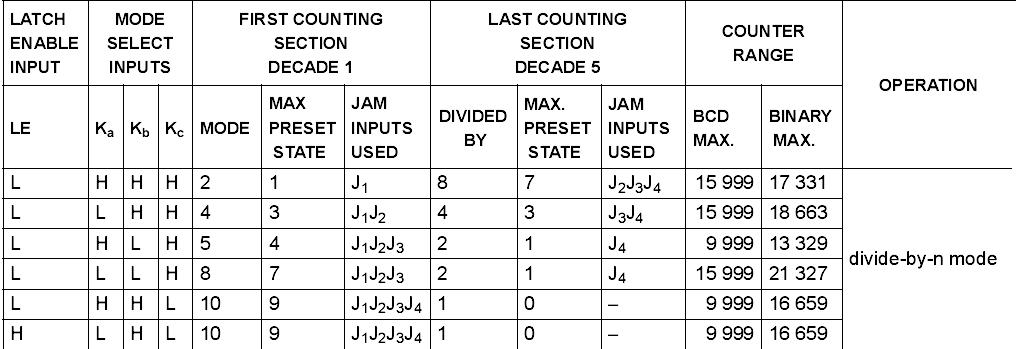

In the datasheet, they said there's 4 modes of operation, controlled by Ka, Kb and Kc. and one of the mode is to set divide-by-n. Later on, i got confused when they show how to determine the value of n. For example, this part:
n = (MODE ) (1 000 x decade 5 preset + 100 x decade 4 preset + 10 x decade 3 preset
+ 1 x decade 2 preset) + decade 1 preset
Does this mean my n will be depending on 5 Preset values and 1 Mode value?
That means, to select a value for N, i will be inputting data to set this 6 values. Am i right? and the values of n can be as low as 3 and as high as 15999?

so n = 4(1000x3 + 100x15 + 10x15 + 1x15) + 3 = 18663. Why am i not getting 15999? Or the datasheet just indicates that the IC is not capable of going beyond 15999? I do realise that under "binary Max" they indicate as 18663. What does this mean?
Also, referring to the table that ive attached, under decade 5, there is a column titled "divided by". Where does this fit in the equation?

This IC is fascinating. I realised that I made a mistake. The max preset for decade 2, 3, and 4 ought to be 9 instead of 15, since it is a BCD counter. Now it makes sense since n = 4(1000x3 + 100x9 + 10x9 + 1x9) + 3 = 15999 :)
You are becoming an expert.
Oh boy, now I have to study some more to give a good answer. ... OK, now I've done it, and the answer is yes.
Yes.
Yes. Pretty neat, eh?

Mode = 4.
Max Decade 1 preset = 3,
max decade 2 preset = 15,
max decade 3 preset = 15,
max decade 4 preset = 15,
max decade 5 preset = 3
I'm not sure, but I think that you can choose to load up to 15 (maximum for 4 bit binary) if you want instead of bcd 9 and this binary choice is called "extended" in the TI data sheet but the numbers given match the "binary max" in the Philips sheet. So they give maximums for loading up to 9 and for loading up to 15. This is confusing.
