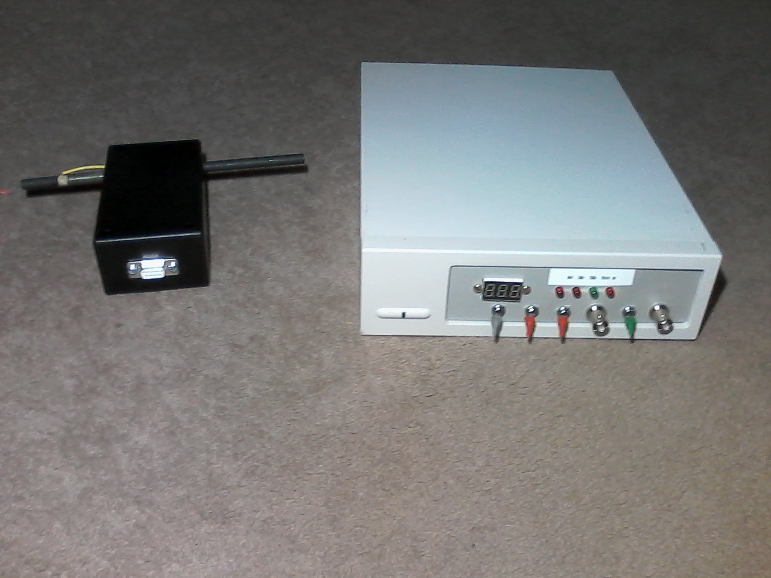

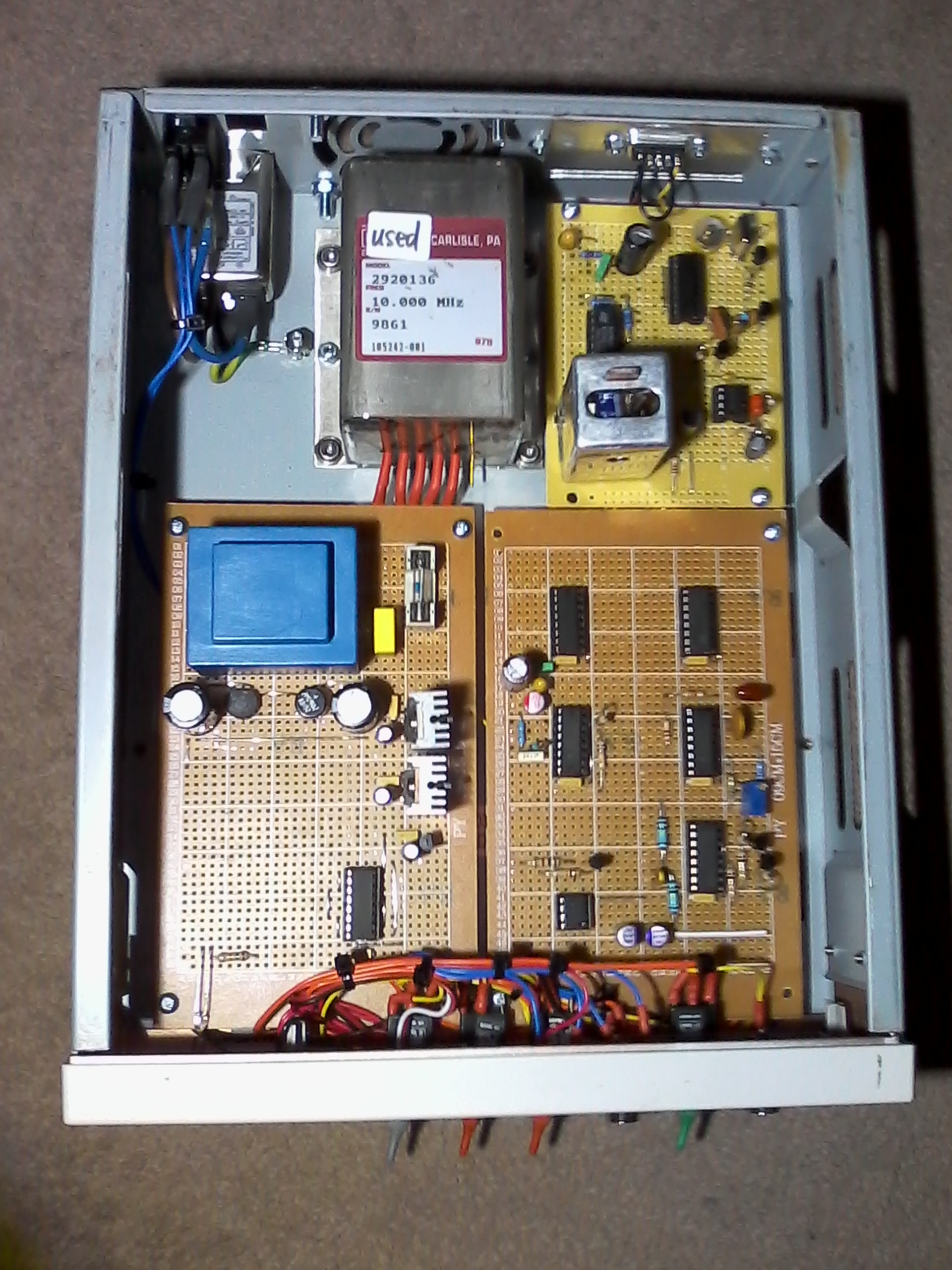

Well initially I was discussing whether to use radio 4 or Msf as a source for my frequency standard, hence the title.
Looks like I now have both, I recently finished my Msf standard.
It has a crystal filter on the Msf front end, 3 phase locked loops and a propriety crystal oven, o/p's are 1mc and 10mc switchable, the meter shows the loop voltages of the Pll's.
Accuracy as far as I can tell is as good as the Msf transmission.
