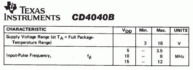

How do I make a frequency counter? do I mix a 4040 counter chip with something? Is there some simple block-diagram circuit you can show me?
I don't think a 4040 will count VHF FM broadcast band frequencies with its very limited high frequency counting ability. Besides, it is a ripple counter so its outputs aren't syncronized.
