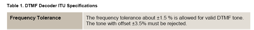

I use a PIC chip to produce DTMF so the int oscillator is perfectly suited for this close-tolerance requirement.
Well, since I am old enough to remember telephones (and I still have some) with L-C oscillators to make DTMF tones, obviously the central-office DTMF tone-decoders are not very fussy. In fact, +-1.5% is still a valid tone, and +-3.5% is not. Doesn't particularly recommend the internal osc inside the PIC.

Special Microcontroller Features: • Precision Internal Oscillator: - Factory calibrated
to ±1%, typical
to ±1%, typical
