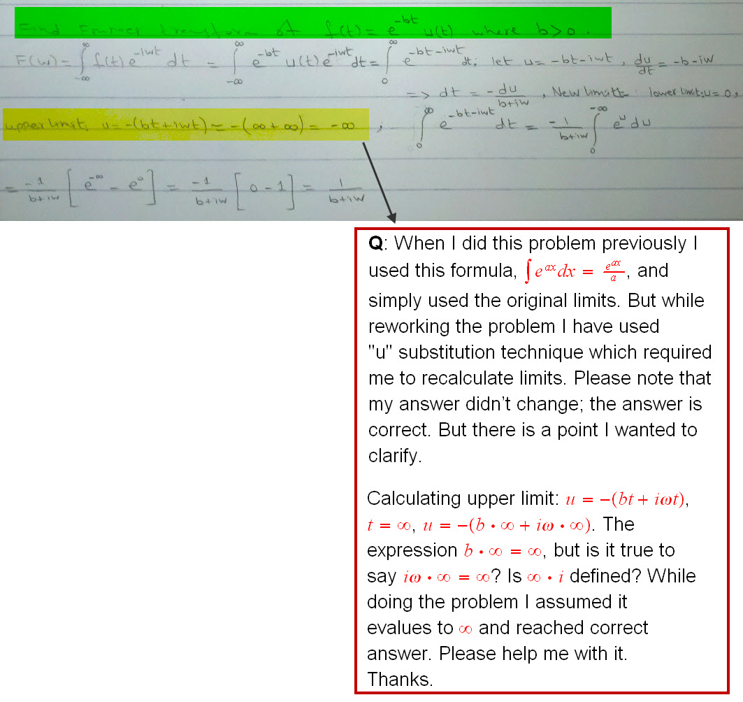

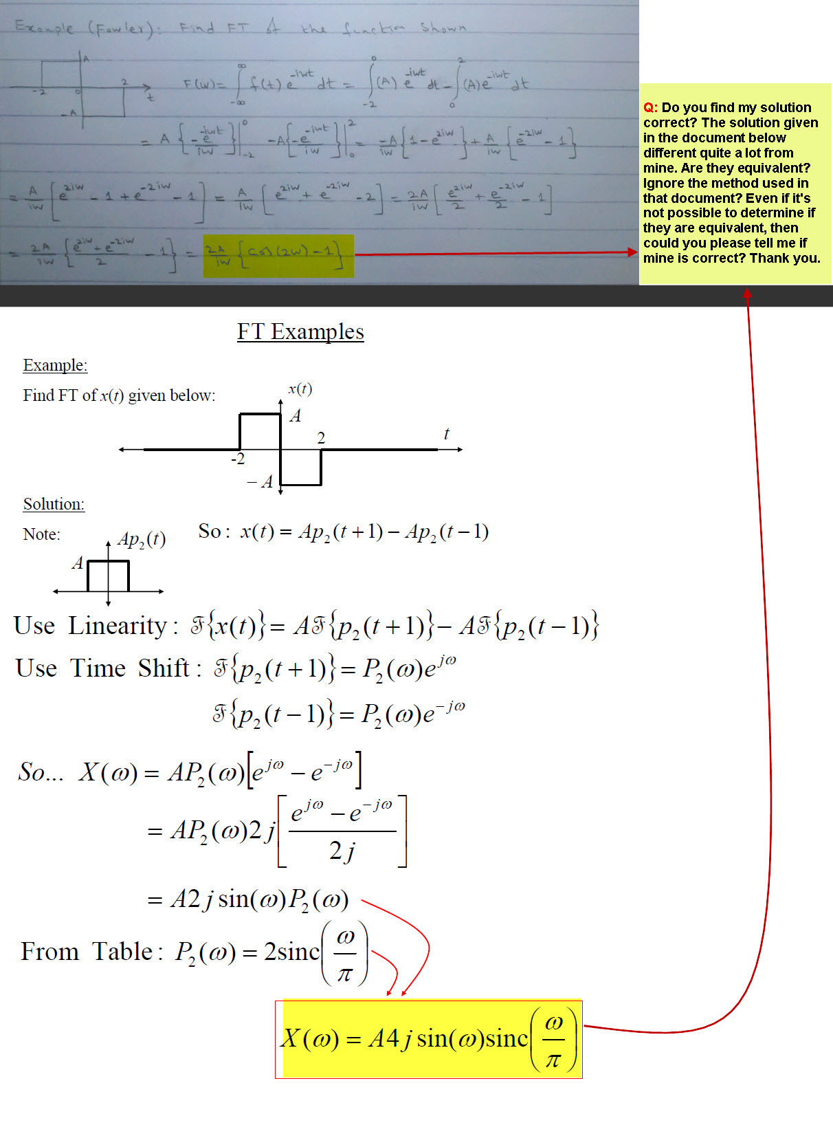

Could you please help me with these queries Q1, Q2 and Q3? Thanks a lot.

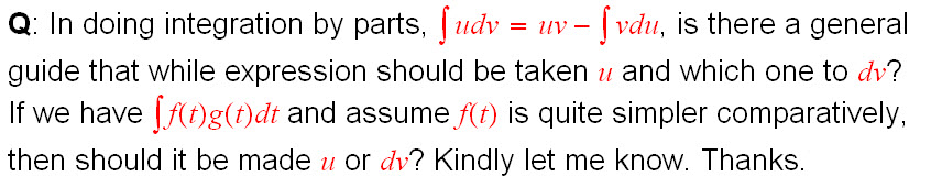

Q1: I'm not aware of a method. Personally, I just use intuition and trial-and-error.
Q2: You need to formally take the limit as the value goes to infinity. Keep in mind that exp(iw) as w goes to infinity, does not coverge to any finiite number, but it does oscillate and maintains a finite value (i.e. it does not go to infinity). However exp(w) goes to zero as w goes to infinity. These two facts help you get the right answer. exp(w+iw)=exp(w)exp(iw), and zero multiplied by a number that does not go to infinity is zero.
Q3: A quick glance and my recollection that 1-cos2x can be related to 2(sin(x))^2 tells me that your answer is probably correct and should match the book answer. However, this is a good example of how you should be able to check answers yourself. Even if you didn't see the trig identity and the way to formally show the equivalence. You can check spot values with a calculator or with Matlab. It's clear that they agree when w goes to zero (just take the limit). Then you can check other numbers like w=100 and w=pi and w=4.5676778888. The odds of having a wrong answer match at all these values is very very slim. Do you see how easliy engineers can double check? This is an important skill to learn.
However, being able to show it formally is important too and this is sometimes easy and sometimes hard. Sometimes it is easy and you just have a "brain-freeze" and dont' see the easy way. That's life. :D
