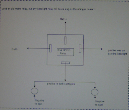

I would appreciate help with the following problem.
I have been given some nice foglights for my escort van, includes the relay,but, the lights did not come with a diagram on how to fit.
Has anyone got such a diagram they could share or any ideas besides buying a new lot.
Any help would be appreciated.
Donny
Its ok guys me and me trusty metre have saved the day, i have now sorted it.
