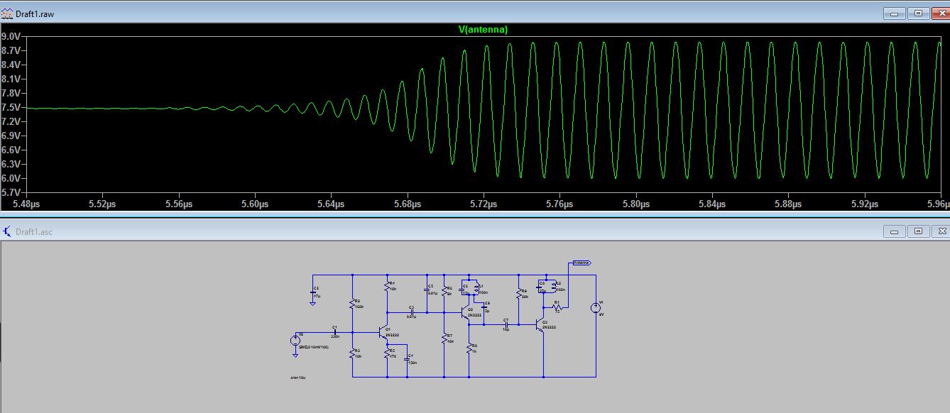

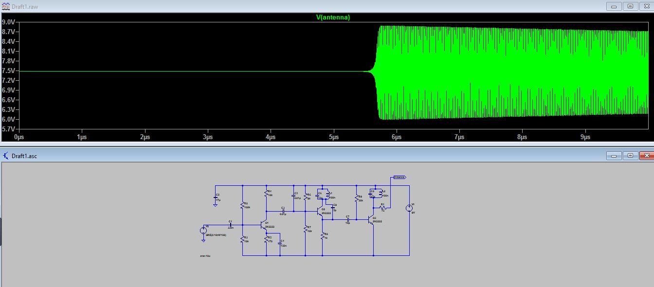

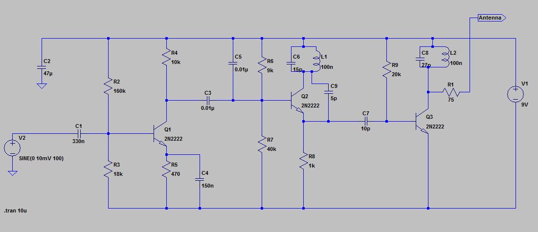

Why the starting part of the waveform is in flat form? Here I attached my asc.file. So, can you help me to correct any wrong counting value of the component?

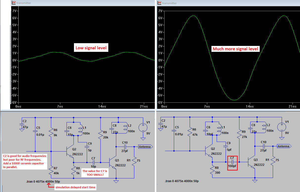

You have the simulation beginning at the start but it takes time for the signal of a sinewave oscillator to build up. My simulation has a delay at the beginning.
The antenna is an impedance to ground, not in series.
Your value for C7 was not calculated correctly so it attenuates the signal.
Your value for C3 is way too small for audio.
I also changed a couple of resistor values.

If you build the circuit then you will find that the audio will sound like little high pitched squeaks because the small value of C3 will not pass low audio frequencies.
The value of C4 is 150nF for 75μs of pre-emphasis for North America. 100nF is used for 50μs in Europe and Australia.

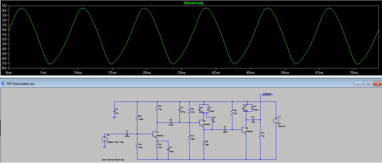

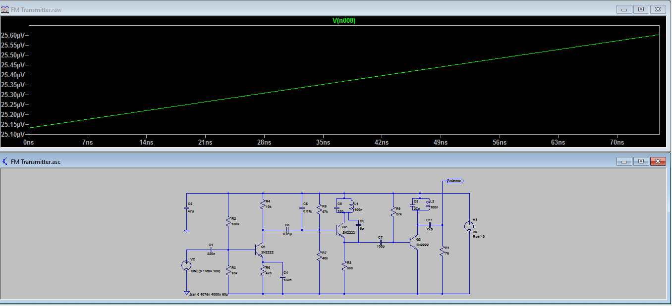

V2 is an audio signal of 100Hz. You have the TRAN (at the bottom) setup to see 100MHz. In my simulation I have TRAN set as .tran 0 180m 120m 50m to see the 100Hz input audio signal, and the output of Q1.
The value of C3 is still much too small. Use 0.33uF (330nF) which is 33 times the value of your 0.01uF.

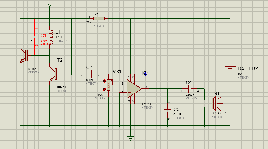

Can this receiver circuit detect the transmitted wave from my FM transmitter and produce sound through the loudspeaker?
The two transistors are not biased properly and they are not an FM detector anyway so they do nothing.
The old 741 is an opamp that has an output current that is too small to drive a speaker. It is also is not biased properly and does not have any negative feedback so it will not work.
The original circuit you copied from **broken link removed** in India has the same transistor circuit that does nothing but it almost correctly uses an LM386 power amplifier that has built-in biasing and built-in negative feedback. It is missing an important resistor in series with the capacitor to ground on the output that is shown in the datasheet of the LM386. The comments on that website say the circuit does not work. I think most circuits on that site do not work. It copied a circuit of mine but changed a few things that made it not work.

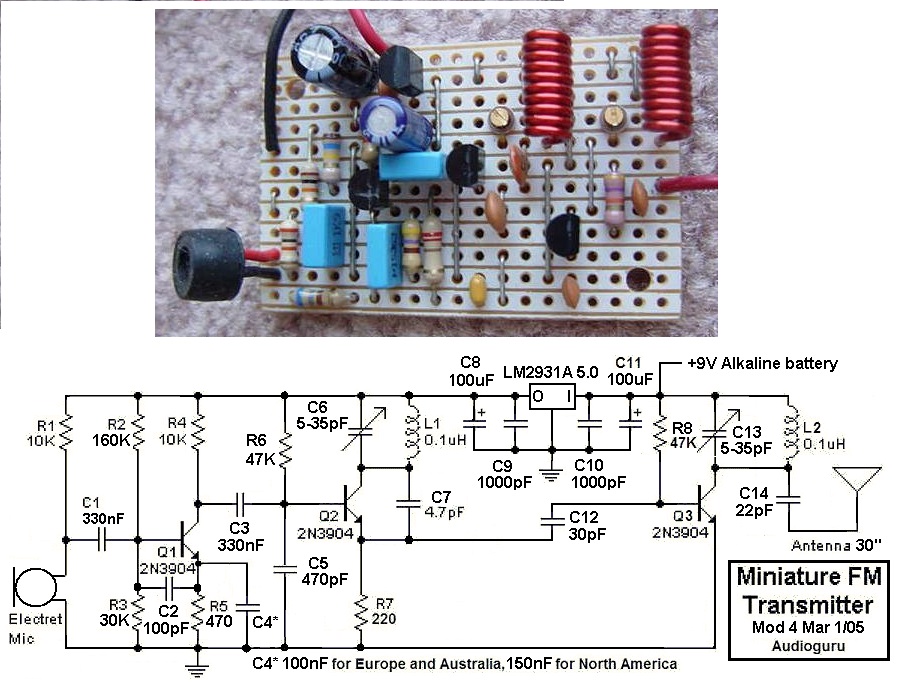

Somebody posted a defective FM transmitter circuit that they found on the internet. I looked at its schematic and explained why it did not work but they did not believe me so I fixed its 4 problems, one at a time:
1) Its mic preamp transistor was poorly biased so it was saturated and did not work when there was a new 9V battery and the transistor was cutoff and also did not work when the battery voltage ran down a little. So I biased it correctly and added a voltage regulator.
2) The radio frequency changed as the battery voltage ran down. So I powered the FM oscillator from the voltage regulator that I added.
3) The radio also frequency changed when something moved towards or away from the antenna. So I added an RF amplifier transistor to isolate the FM oscillator from the antenna.
4) The sounds were muffled with no high audio frequencies when heard on any FM radio. So I added pre-emphasis (treble frequencies boost) like all FM radio stations have that matches the de-emphasis (treble frequencies and hiss reduction) like all FM radios have.
I called my project "FM tx mod4" and here it is:
