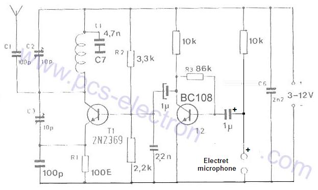

Im building a FM transmitter but it just doesn`t work well.ive been building about 4-5 diff types just to at least get the working one.ive got all the parts correctly but only for the inductance (which have to be hand made) and the elecret mic.
the problems:
1-1st circuit : can transmit but gone in just 1m.(the circuit should be about 100m)
2- 2nd circuit : nothing (no hawling sound and no voice)
3- 3rd circuit : got howling sound but no voice (claimed to be 200m-500m by pcs-electronics web)
questions:
1. since all the parts and connection been triple check i assumed it should be the coil for the inductance.what are the diff between the AWG and SWG copper magnet wire should be used to wind as the inductance.i couldn`t get the AWG wire but just the SWG. is it the AWG for the US and SWG for asia? (im in asia)
2. is that copper wire that should be use is the same as in the dc motor winding? can i just use the normal single core wire as the inductance? will that affact the circuit?
3.how to actually solder the copper wire to the vero_board since i found it couldn`t be soldered (im using the SWG). can it be replace with the fix one stated 1uH or anything similar the the value of henry given by the coil by using the henry equation.how does the diameter of the copper wire affect the henry value since i found no diameter needed in the henry equation.
4. how to actually wind the copper wire.should it be a gap between the loop.can i just subs the copper wire using the normal single core wire by stripping the insulator.
5.how does actually the electret mic looks like?is it a small one with a size of a button of a shirt diameter?how will the internal resistance of the electret mic affect the circuit .ive got a few of them but with diff internal resistance (by taping bot mic`s pin with the multimeter and check for resistance).

Hi Manz,
The FM transmitter circuits you built that made howling noise worked! :lol:
The howling noise is called acoustical feedback, and is caused when the microphone can hear the radio which amplifies it, its sound goes through the air back to the microphone and it is transmitted to the radio again that amplifies it more and around and around the sound goes making the howling sound. Use earphones on the radio and keep its volume down to stop the howling.
Motor winding wire is insulated with a thin coating of varnish or enamel. It must be removed from the ends of the wire by scraping with a sharp knife or with sandpaper, before the bare copper wire can be soldered.
Many cheap radios are overloaded by the transmitter when they are close together and you might be tuning it to an overload interference point on the dial instead of the main strong frequency, which makes the transmission seem like a short distance. My cheap Walkman radio has a local/dx switch and is not sensitive to overload when switched to local and I can tune it to my transmitter, then I switch it to dx where it is very sensitive for long range reception. :lol:
thanks for the info. for the copper wire : the problem solved, that is to solder the wire to the v`board. and it should be due to the coating tht it seem like not conductive (multimeter).
ok now for the howling sound : it seems like there`s a transmitter and reciever feedback.that `woooo` sound itsn`t it? if i tune the variable caps to some point i`ll get the sound but i can`t speak through the mic.there`s no sound been transmit.even if i change with other electret mic (in case the one i`m using is not in good condition). is it because the mic`s resistance dind`t match the circuit. is there such a thing?

You CAN'T build VHF radio circuits on a breadboard, it's completely unsuitable - see the many similar posts in the past!. You would be better off building Audioguru's improved version (which fixes many of the problems with the original circuits) - he also has posted pictures of the veroboard layout he used.

Hi Manz,
The instructions for your extremely simple FM transmitter circuit says to use a "mik", which is probably a dynamic microphone (coil and magnet), not an electret one that needs a resistor to the positive power supply to power its FET transistor inside. Try it modified for an electret microphone like this:

thanks a lot for the info.. i`ll try with the modified circuit... i`ll let u know how it goes in a while... anyway i`ve look to your fm transmitter circuit mod3 (told by Nigel Goodwin-tq).. if everything is working well with what i`m working now, i`ll for sure proceed with your enhanced circuit. i just dont have the confidence yet to proceed so that`s why i try with the simpler one first..
for the mean time i`m working it on a veroboard. is it ok on the veroboard. i`ll keep everything closed togeter though..

On my Verobaord I cut all tracks to minimum length. My mod4 version is much better because it uses a low-dropout voltage regulator for its audio preamp and RF oscillator. Its audio is very clear and its RF frequency drifts very little compared to the loss of treble, high distortion and high amount of drift with simple circuits. :lol:
