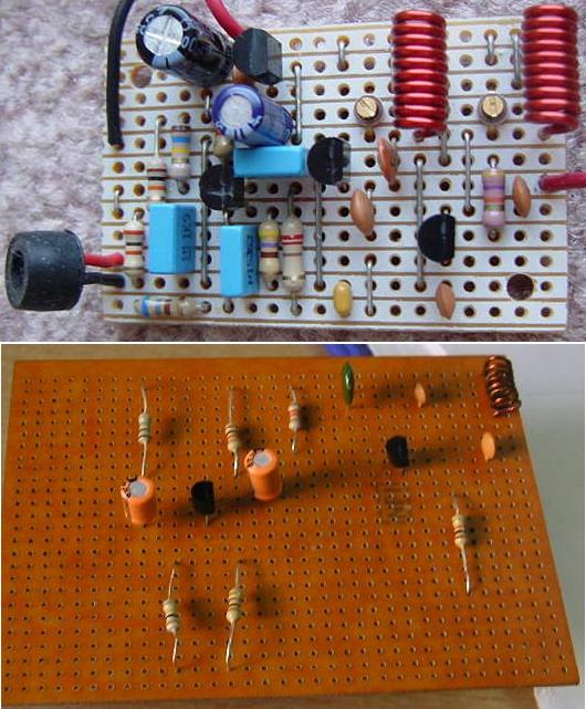

I built my FM transmitter on Veroboard. I carefully planned the parts placement so each wire is less than 1cm long. It works fine.
Other guys said their transmitter didn't work. They had parts far apart all over the place.
See the difference, and mine had many more parts>
For someone with zero soldering skills, do you recommend me to do my project on the Veroboard or am I better off with PCB? Also how did you solder the bottom? Do you have a pic of that as well?
Veroboard has strips of copper that I cut to the proper length with a drill bit, then I soldered all the parts and a few jumpers to it. Sorry, no pic.

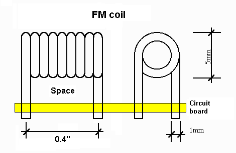

I'm curious if you wound your own inductors or did you buy the exact inductances???

It took me anout 1 minute to make my inductors and another minute to sand off the enamel at the ends. I don't think anyone sells inductors so simple and cheap. I just copied this one from another FM transmitter project:

Does it matter what kind of capacitors/resistors used? I'm building your Mod 3, but nothing is working. Might be because of my inductor. I just used some cheap wires to wound it; it bends very easily. If you have any tips please let me know. Maybe I'll just build your mod 4.

Of course it does. Many radio circuits need ceramic disc capacitors because they have very low inductance. Wirewound resistors are also inductors and cannot be used.

Make it like mine. Use ceramic disc capacitors and very short wires. Another guy made a much simpler FM transmitter with its parts spread out and it didn't work. Here are pics for a comparison:

Use 1mm enamelled wire like I did or your transmitter probably won't work. I got my wire from a 2-way speaker's crossover coil.
A battery doesn't make noise at 89MHz.
An RC filter will just reduce the voltage to the circuit.
My Mod3 transmitter drifted its RF frequency as its battery ran down. Mod4 has a 5V low dropout voltage regulator to fix the drift.
RadioShack overcharges for the few simple parts they sell. Any real electronic parts distributor has low dropout voltage regulators.
