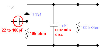

To tune the output amplifier of my FM transmitter i made a VHF AM detector which I connected to my DMM with very short wires. The output voltage was nearly 1V when it had a short antenna and was about 1m from my transmitter's antenna. The tuning was very broad. When peaked at 98MHz the output was only a little lower at 88MHz and at 108MHz.
Here is the schematic of my detector:
