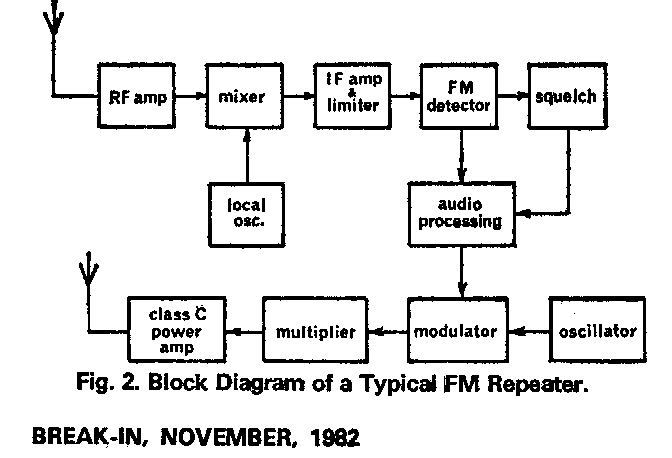

I think I first need to get a better idea of the stages in the FM receiver. Is this basically what a receiver looks like accept for the repeater part?

is that block diagram that i posted correct? I would like to know exactly what I am doing.

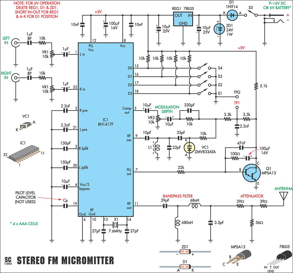

Search Google for stereo FM transmitter. On page 6 you will have a free link to the whole project. Here's its schematic:

The Silicon Chip transmitter project uses a crystal and Phase Locked Loop for rock-solid radio frequency stability. It also must have a very strong RF output because Silicon Chip added an output attenuator. Zach could bypass the attenuator for very good range.
The IC costs only about $2.90US and I think it is exactly what Zach needs. It only has high distortion when in stereo, it is fine in mono which is how Zach will use it.

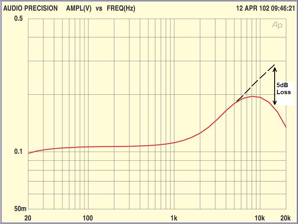

I recently noticed that its simple "brick-wall" low-pass-filter not only doesn't reduce input audio frequencies near 19KHz very much, causing beating distortion, but it also reduces audio frequencies above only about 6KHz. I figure that the frequency response at 15KHz is down about 5dB.
Also let us know what this high frequency loss sounds like and here's another one, Pike:

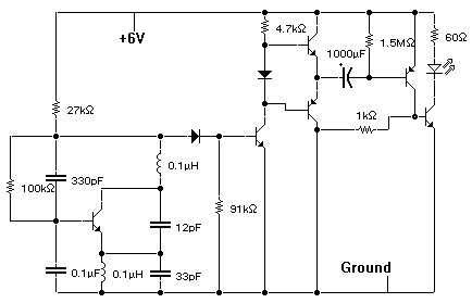

I think Mctechca's "some wonderful glorious super sensitive radio" is the super-regen that he modified and posted awhile ago.
It is the single transistor at the left side of his schematic:
Hi Zach,
Things wrong with a super-regen radio:
1) Its selectivity is terrible because a super-regen has just a single tuned circuit. It is also overloaded easily by stations it is not tuned to. A real radio has many tuned circuits.
2) Its noise level is high and it overloads easily by the station it is tuned to because it is oscillating all the time (quenched, in bursts).
3) The bandwidth is too narrow for proper FM broadcast reception, with lots of distortion, because it "amplifies" with positive feedback instead of gain.
4) It doesn't even have an FM detector. It is basically an AM radio that detects the amplitude change of the changing frequencies of an FM signal when the station is tuned to the slope of its tuned circuit. Therefore it is more sensitive to AM interference (tuned at the peak) and less sensitive to FM (tuned to one side).
5) It picks-up all kinds of static and other interference that is ignored by the limiter and FM detector of a real FM radio, because it has an AM detector.
6) For it to be sensitive you must fiddle with its sensitivity control (amount of positive feedback).
7) The super-regen's audio output fades away and gets very difficult to tune and re-tune as its tuned signal gets weaker. That's why Mstechca needs an audio amplifier with a lot of gain. Its noise level stays the same. A real FM radio's audio level stays the same as its tuned signal weakens (but its noise level increases).
8) A real FM radio's noise level decreases with increased signal strength, because it has lots of gain and limiting. So a signal that is only just a little stronger than what is barely detectable is heard without noise (quieting).
There are probably more things wrong with a simple super-regen that I can't think of.
Notice that the purpose of the original project was as a cheap tracking receiver for a transmitted tone, not music or speech. Quality (low noise and distortion) didn't matter. Just another "wonderful glorious super sensitive radio".
