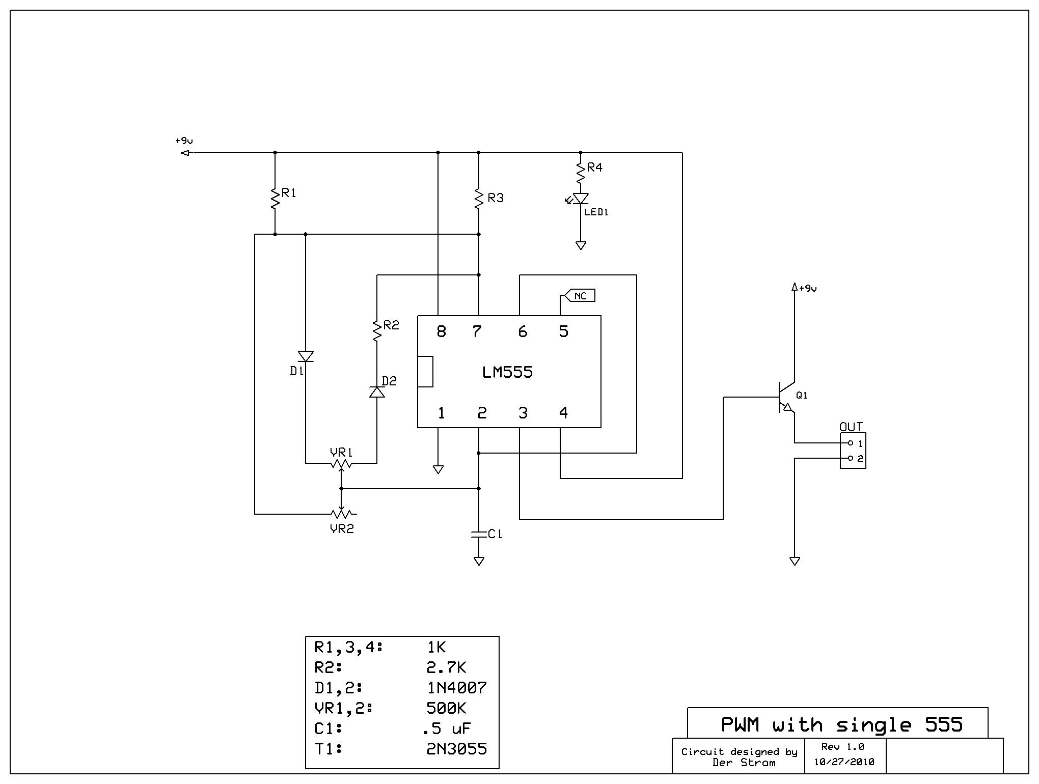

It occurred to me that it may work better to have an adjustable duty-cycle. Here's a circuit very similar to the one you have, with a couple of modifications to make the duty cycle adjustable:
Just be sure to connect pin 5 through a .01uF capacitor to ground (even though it says NC). Also, replace the transistor in this circuit with the MOSFET part of your other 555 circuit. It is definitely worth a try. Many transformers such as these are very "picky" when it comes to the duty cycle of the driver signal. Having everything adjustable may help.

i chked ur circuit. the circuit i hv made already has adjustable duty cycle- thats what the 100k variable resistor is for.
well, the final option for the lifter is the tv itself, but that wont fetch much marks. a self made circuit is more imperssive
The 100K pot is for adjusting the frequency, not the duty cycle. You would need a different circuit to be able to adjust duty cycle with a pot as well.
