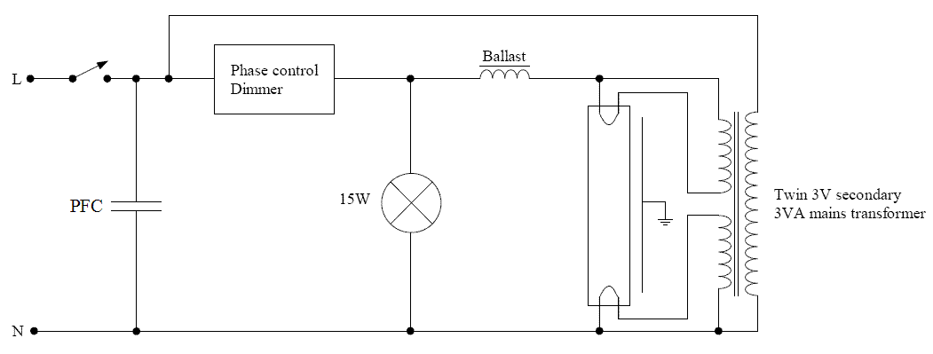

Here's an example of a circuit which I designed awhile ago.
I don't know how well it works but someone on another forum built it and it worked.
The incandescent bulb might need increasing up to 40W depending on the dimmer's minimum wattage rating.
