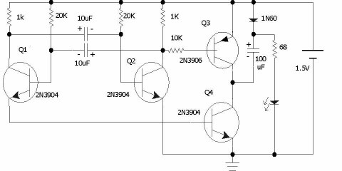

Here is a circuit I designed a number of years ago that works quite well
