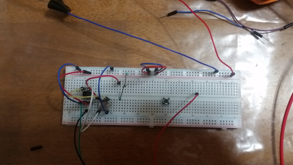

I am a bit confused.
If I put meter leads on pin 3 and ground, how can I test resistance of resistor?

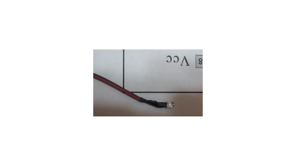

I want to add this led and a switch to my breadboard so don't have to keep plugging in my power supply.
It has a built in resistor. Sorry, it did not come with a data sheet.
Will adding this add any complication to the laser alarm project?

yes, very strange results.
take a pic of your breadboad.
Some breadboards have break in the "power" busses, some don't. In other words if this is a about a 3" x 8" bread board with two
busses" on the top and bottom. Those 2 busses might actually be 6. The outer two traces Corner to corner on the long edge is not continuous.
The one on this https://www.baldengineer.com/electronics-introduction-to-breadboards.html page isn't.
EDIT: 4 changed to 6 busses
lol.. leave the meter on pin3 & gnd power circuit and test the volts
use the resistor or one of your jumpers to hook up pin 6 to first power , then ground but not at the same time

I think I have got it going. :)
I did not have all the pins going to Vcc.
And R2 is a 220 ohm resistor.
I substituted a 12 v led(with built in resistor) for the piezo buzzer.
With no laser light, the led lights.
With laser pointed at the LDR, led turns off.
Is that what it is supposed to do?
You need R1. It's not a critical value. During the time the output is going off, there is a momentary short through the timer ground to Vcc. This could definitely degrade the timer.
Do you have any resistors close to 1K and (9-10K)?
remove R1 and R3 (Photocell).
Substitute around 1K for R1 and 9K for R3. Jumper R3 with a solid wire briefly to simulate laser light and 9K without.
