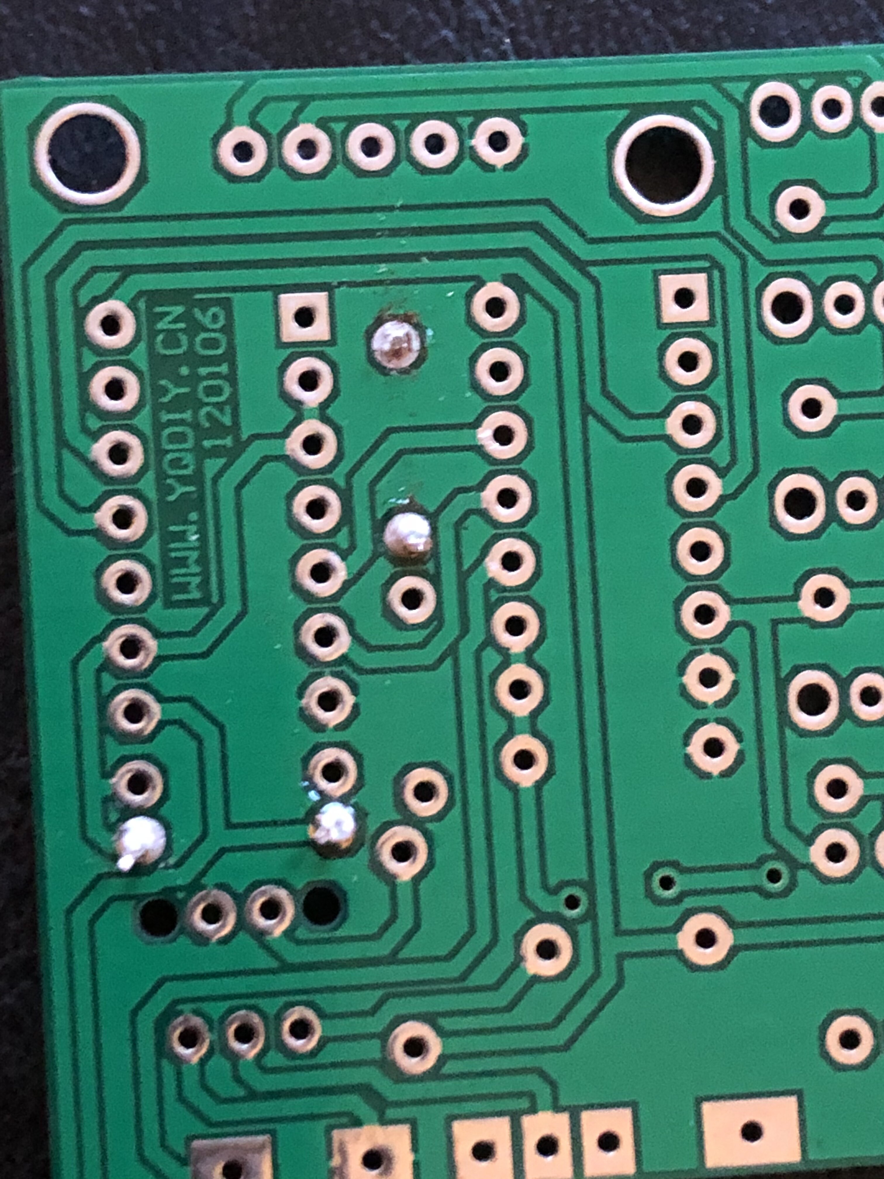

First time soldering
Tmcca
Trying to see if I am doing it correctly before I proceed

Looks OK for a first attempt.
Critical comments:
Three of the joints may have a little bit more than the ideal amount of solder. It is difficult to tell from directly above.
Try not to scratch the solder resist (the green covering over the copper tracks) it looks untidy, but does not affect circuit operation.
You forgot to tell us the important make and model of your soldering iron and solder.
Most noobs use a very cheap soldering iron that has no control of its temperature. Usually it is way too hot and incinerates the flux in the solder.
Some noobs use plumber's solder instead of electronics solder.
The solder should have a rosin core and tin/lead 63/37 works better than tin/lead 60/40.
They look a little grey which could indicate a dry joint. A picture from the side would be more useful.
The joints don't look bad.
Comments:
1. Use the soldering tip to push the lead of the component and to heat the pad. Apply solder to the pad and opposite sde of the soldering tip. <Solder><lead><Iron>
<Pad..........<Lead><iron>
........................<lead>
In other words do not apply solder to the tip of the soldering iron except to tin it.
2. Clean the flux off promptly.
This is a diy kit to practice soldering. I will get another pic. Maybe I should get a holder as well to make it easier to solder.
