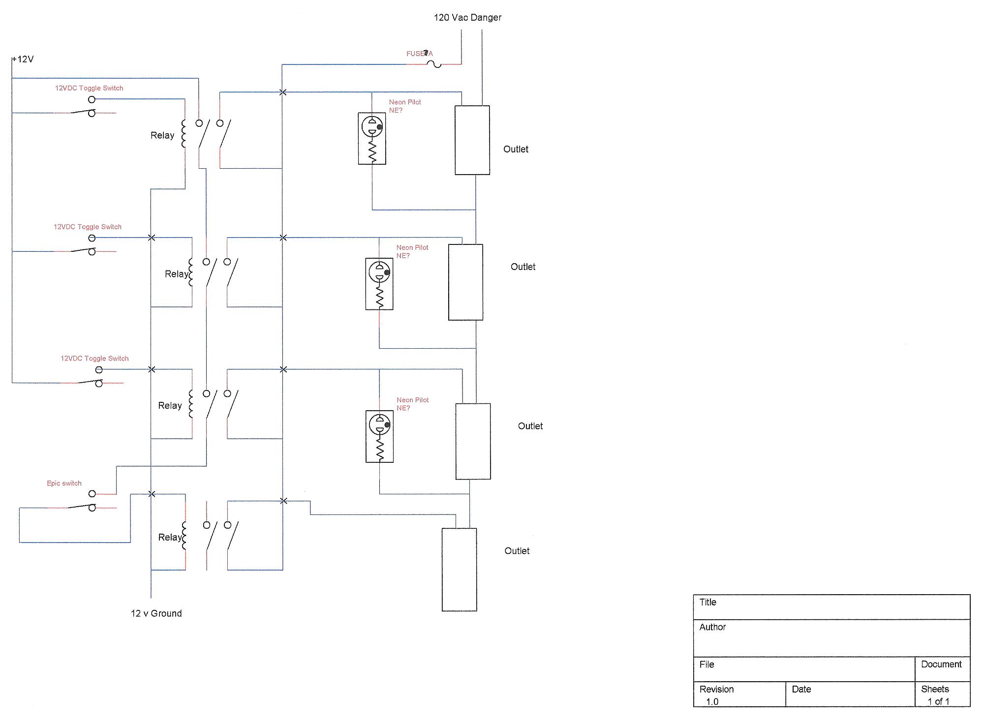

Here is a schematic of what you will have to do.

I don't want independant control over any of them. I want the lights to all go on when all three switches are on and the big pushbutton is pressed. The schematic looks fairly simple, but it looks like each switch controls its own outlet...which is not what I want.
Okay.... so what do the 3 switches do then? I am confused.:confused:
I was thinking each switch controlled a type of light.

Do you want it set up so that nothing will come on until all 3 switches are on?
I don't see the reason for something like this.
Just put all three switches in series for that.
Yea I just need them all in series. The switches just make it looks badass. I guess a better way to describe it, without all 3 switches in the ON position, the button doesnt work, and the button turns everything on at the same time.
Thats a bit simpler yet then. :)
You will only need one relay, but it will have to be a bigger one, able to handle the total current of all the lights added together.
Like Duffy said, the switces will just get wired in series, meaning SW1 will supply power to SW2 and so on, down the line to the epic button.

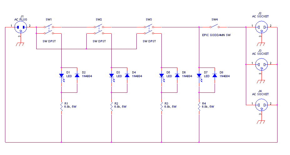

yes that sounds exactly like what i want to do. is it possible to wire both the LED and the next switch/button up to a spst switch, or is that a noob mistake?
also, in terms of the relay, im not familiar with them at all...so what exactly am i looking for/how would that figure into the circuit?
I don't think you need the relay, so long as all the switches are rated for the maximum current. The relay was because we thought you wanted something more complicated.
You want to get DPST (or DPDT) switches for the three toggles. One pole goes to the high voltage series circuit, the other pole goes to the individual LED by the switch. Then there's a 4th light that only comes on when all 3 switches are thrown for the epic button.
Here's a schematic -
alright thanks. love the name of the final switch too. very nice touch. i also like the extra light...possibly a blinking LED? i'll let you know as soon as i get the parts or if i have any questions before then...
oh and i'm not really sure why the diodes are necessary wiring the one side of the LEDs to the other.
The diodes are necessary because the PIV (Peak Inverse Voltage) rating of the LED's are only a few volts. The 1N4004 conducts on the opposite half-cycle and limits the voltage.
Note that those are five watt resistors - don't use little quarter-watt resistors.
