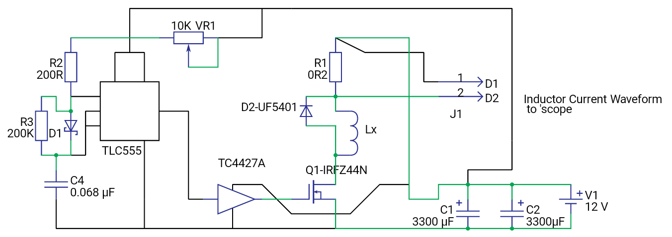

I also built a rig for testing power inductors with the addition of a 'scope. I will attach a copy of its schematic. If you think you could help with the STEPUP idea that would be good. My motivation is purely the joy of learning about a new type of circuit. My workshop is well stocked so Iam able to do a lot of practical experiments and enjoy doing so!
Which version of the circuit do you think holds the most promise? Post #1, #4 or #36?

This is where I got the idea for the Inductor Test Rig: Flyback Converters for Dummies
Hi Gordon,
I would like to work on the first circuit if that is OK with you. Please don't think I am criticizing your work though- the first switch mode PSU I did was just a transistor killer with no output at all. What I propose is is two modification paths resulting in two final circuits, hopefully - have got pretty bad flue at the moment so am not firing on all two cylinders.
Hi Gordon,

Glad you are interested in working on the circuit, I'm eager to learn and at the moment I've just been making educated ( hopefully ) guesses. Still not fully understanding why certain things do / do not happen.
Apparently the Schmitt trigger type regulator that I came up with is called a hysteretic converter. I can honestly say that I've never heard of this topology and briefly wondered if I'd actually came up with something original! I will admit that I may have come across something similar, but without actual reference to that name.
In view of your positive response I will go through some of the design processes as we go along- please don't think I am being patronizing. Would you be happy to go for another switching power transistor. The BD139 family are rather difficult in this application.
