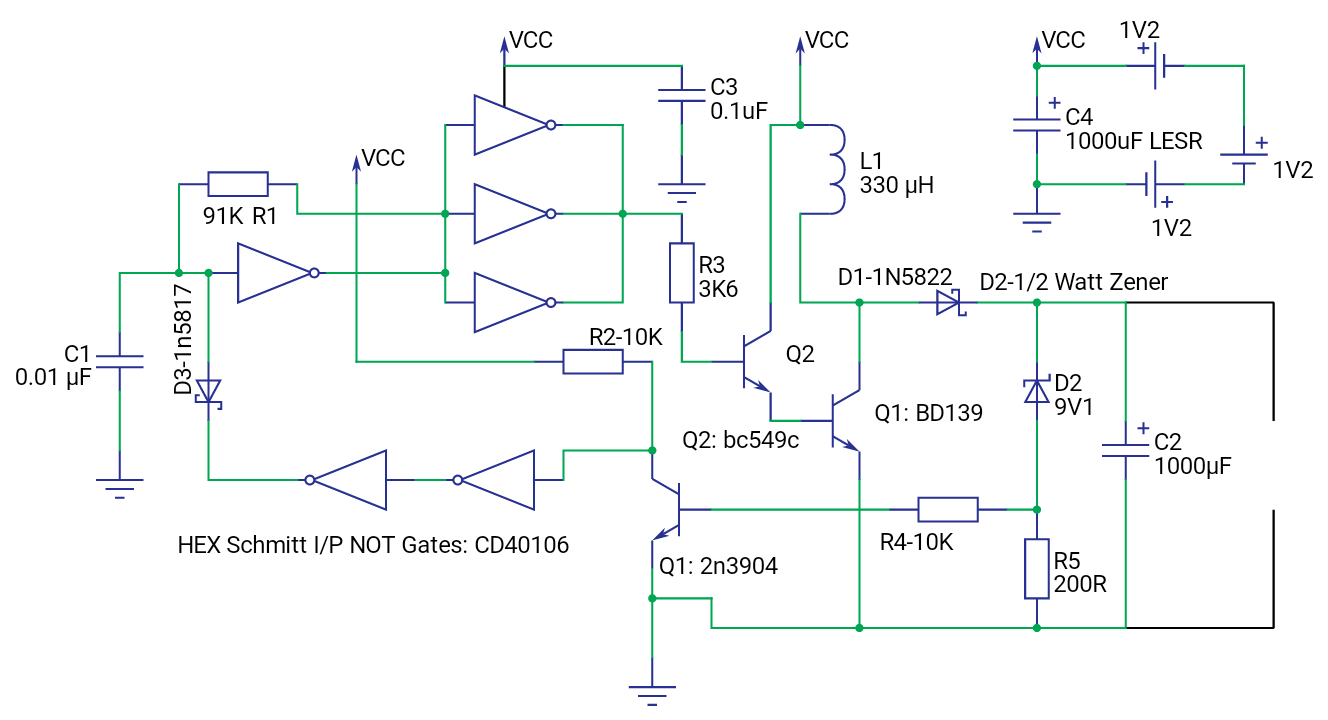

ref your schem of post 4 or 5 back, you have no current sense filter.
I don't see output voltage feedback divider.
You know the TL431 needs to drink a good milliamp just as bias current
Better to have at least some fet GS resistance, eg 22k or something
Surely your current sense resistor voltage amp has to be non inverting.
You can simulate that in ltspice, do you want me to send you the logic blocks? (inverting Schmitt triggers)

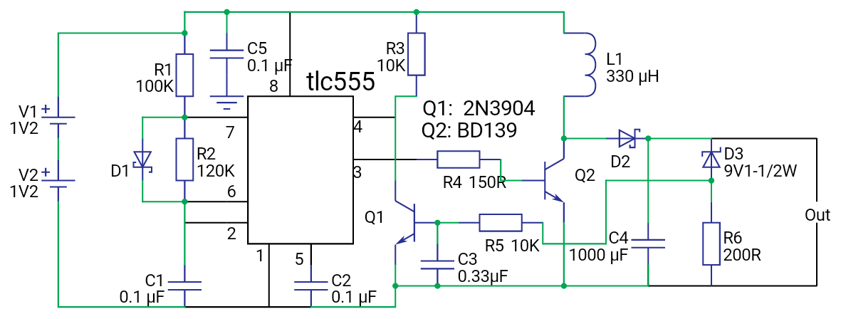

I wanted to have a go at designing a boost converter that could power say a 9volt circuit from 2 x NiMH cells. The circuit works quite well in fact with as much as 85% efficiency. My problem is that at certain combinations of input voltage and / or load it becomes unstable with the output voltage cycling up and down over about a 300mV range. R5 & C3 were a crude attempt at compensation ( a subject that I can't really claim to understand very well ) from the little I do know I suspect that the problem is related to compensation or lack there of.
Hello Gordon,
Is that your first switch mode power supply design? If so it's a damn good circuit. You certainly jump in at the deep end- not many SMPSUs will work off 2.5V.
I can see a couple of areas that might be giving you problems. As I don't have a workshop I would be very interested in developing your circuit because it would suit an application I have in mind. If so, could you give a datasheet for the inductor or its part number?

LTspice is free and helps you to get a circuit right before making it.
Here is some logic blocks.
You can set the "trip " point of the inverting not gates to be the same as those Schmitt triggers that you have, then they act the same as them
its massively simpler to simulate first, then make later

Thanks Spec. I have been hard at it since about the end of October experimenting with DC to DC converters. Started with simple mc34063 based stuff, see this thread
I done some stuff with the LM2575 boosting its output current with an external P MOSFET. More recently I've been trying to design my own control circuits.
The inductor is a bobbin inductor 330uH rated 2.8A I think R is < 0R1, Iam unable to measure lower than one tenth of an ohm. I have a few if you want one? I bought a large lot of them on eBay a few years ago, sold some and kept the rest, I forget the manufacturer but there is a part number on top of them which I can check if you want to try looking them up.
I also built a rig for testing power inductors with the addition of a 'scope. I will attach a copy of its schematic. If you think you could help with the STEPUP idea that would be good. My motivation is purely the joy of learning about a new type of circuit. My workshop is well stocked so Iam able to do a lot of practical experiments and enjoy doing so!
Which version of the circuit do you think holds the most promise? Post #1, #4 or #36?

I would like to work on the first circuit if that is OK with you. Please don't think I am criticizing your work though- the first switch mode PSU I did was just a transistor killer with no output at all. What I propose is is two modification paths resulting in two final circuits, hopefully - have got pretty bad flue at the moment so am not firing on all two cylinders.

Glad you are interested in working on the circuit, I'm eager to learn and at the moment I've just been making educated ( hopefully ) guesses. Still not fully understanding why certain things do / do not happen.
Apparently the Schmitt trigger type regulator that I came up with is called a hysteretic converter. I can honestly say that I've never heard of this topology and briefly wondered if I'd actually came up with something original! I will admit that I may have come across something similar, but without actual reference to that name.
In view of your positive response I will go through some of the design processes as we go along- please don't think I am being patronizing. Would you be happy to go for another switching power transistor. The BD139 family are rather difficult in this application.
