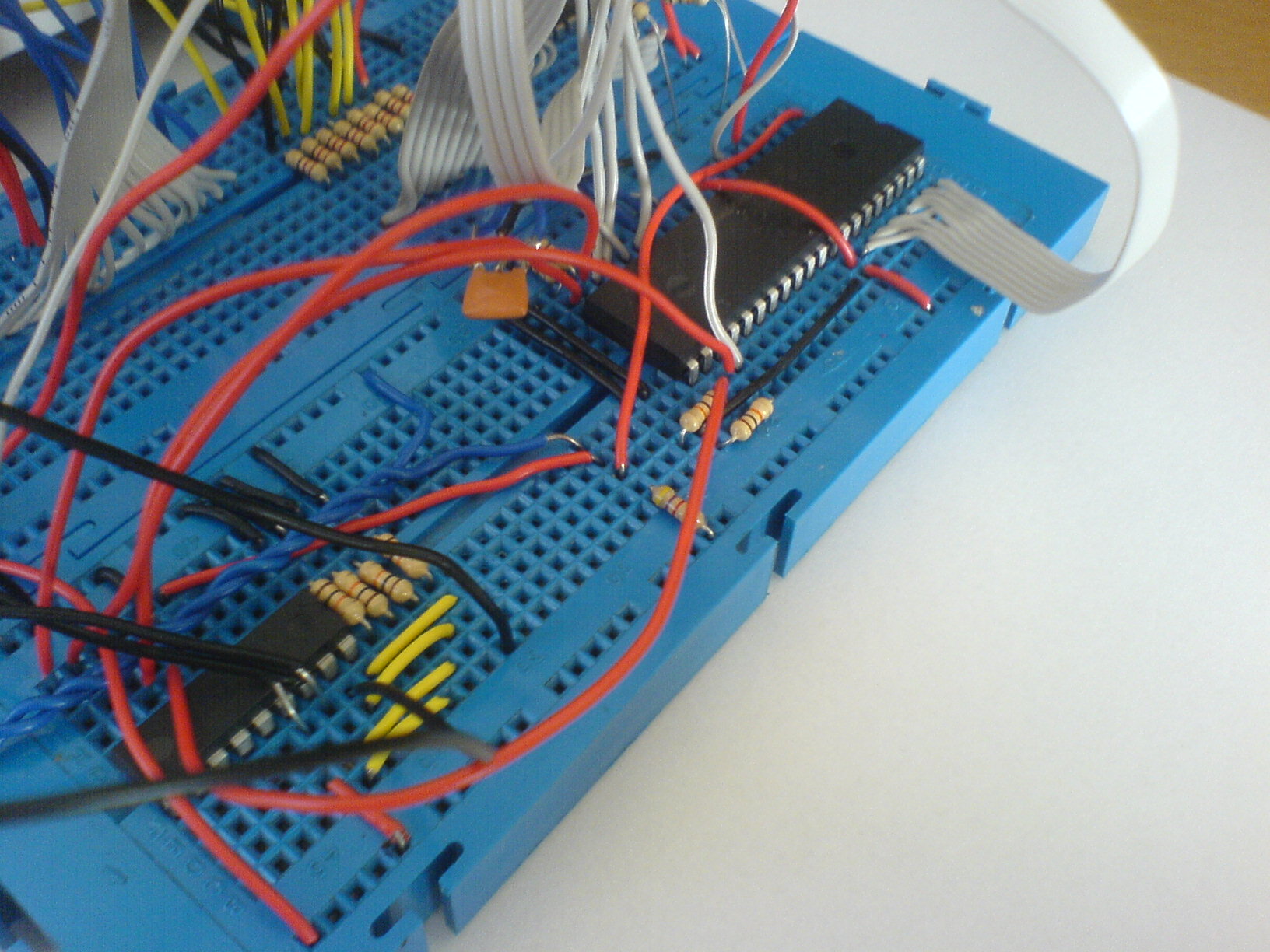

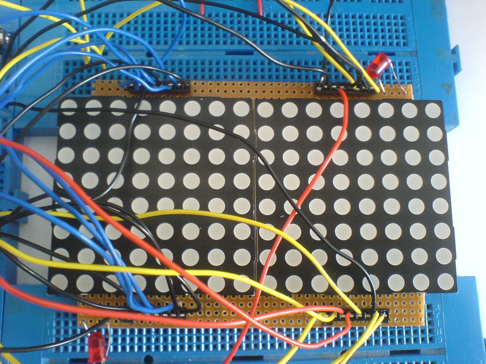

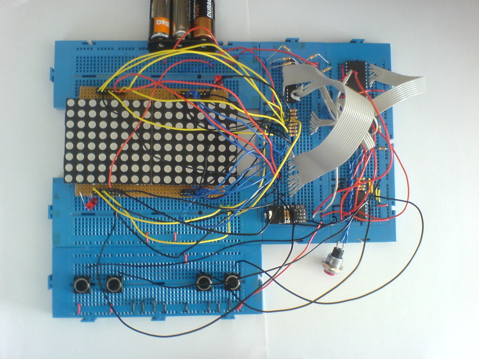

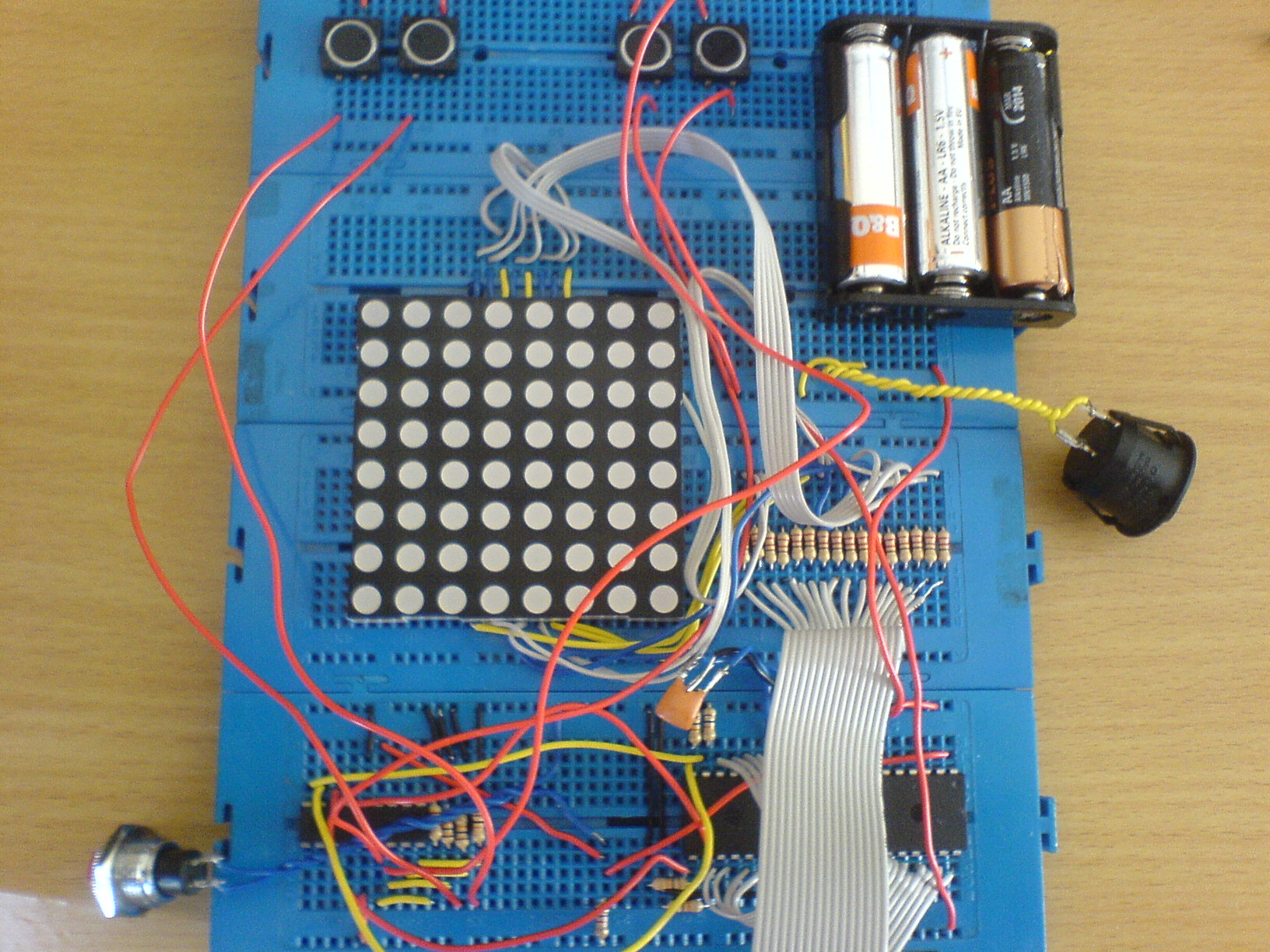

hi for my major project in year 11 i have decided to make a 8x16 dot matrix game. the game is pong for people who dont know what it is its a game with two paddles and a ball the ball bounces around you have to hit it with the paddles the first person to miss loses the game or gains a point mine is lose so far i have design a score keeper which i have yet to make.
i have just finshed prototyping the game on breadboards and i thought i put up some pictures and a small video.

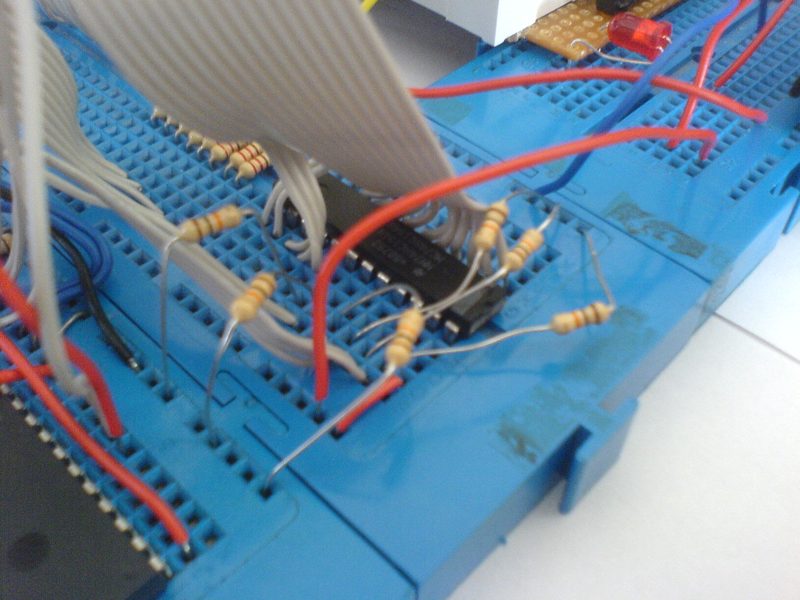

to make this ive used three ic, 1 picaxe 40x1 which controls everthing, 1 picaxe 18 which monitors the inputs and loops until the button is let go as if this was on the picaxe 40x1 it would effect the dot matrix and last i used a 74hc/hct154 4-16 decoder which controls the 16 0v colunms.
will put a video up later thanks for looking

p.s no one has spotted what i did wrong on the first 8x8 matrix in the picture its a stupid misstake :D :p
nope ive put resistor on the postive of the dotmatrix and the negative to they are really dim lol theres like 16
