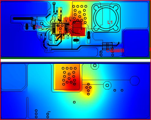

tiny issue here.
heat-jpg.29349
that is the heat simulation for the setup id be using.
but the sim is usually there pre made boards, and its double sided.
since im building this on the same board as the rest of my parts, ill be doing the board myself, and if possible single sided, so i wont have the extra copper traces all over the back for extra head dissipation (as does the pre made board).
