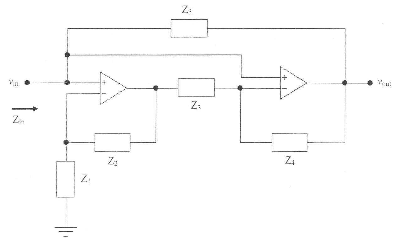

I think, also in case of Twin-T or other active filter circuits you can avoid the time-consuming analysis (starting with basic current-voltage relation). It is much more easy to split the calculation into several steps (like calculation of Hf, Hr and gain) and to combine the various results.
Add a capacitor C in series with the Vin terminal of the circuit shown in the attachment so that the new Vin is the left hand terminal of C.
What are Hf and Hr for the resulting circuit? Is determining them and then applying Black's general formula to get Vout/Vin easier than analyzing the circuit from general principles?
Black`s formula can be applied only for circuits that can be reduced to an amplifier with a single feedback loop.
I never have claimed that all circuits involving feedback (in particular, circuits with nested loops) can be analyzed using Black´s formula.
Of course, I agree with you that your example circuit can and should be analyzed based on "general principles" - however, on a block-by-block basis (using gain expressions for inverting/non-inv. blocks) rather than starting with current-voltage relations.

Hello again,
Ok so you are saying that we would evaluate the forward path by shorting the output, then evaluate the feedback path by shorting the input, then decide what sign we need to use on the feedback and/or forward path. Sounds reasonable i guess :)
Hello again,
Hello MrAl,
Yes- exactly as you said. It is nothing else than a specific application of the rules of superposition.
