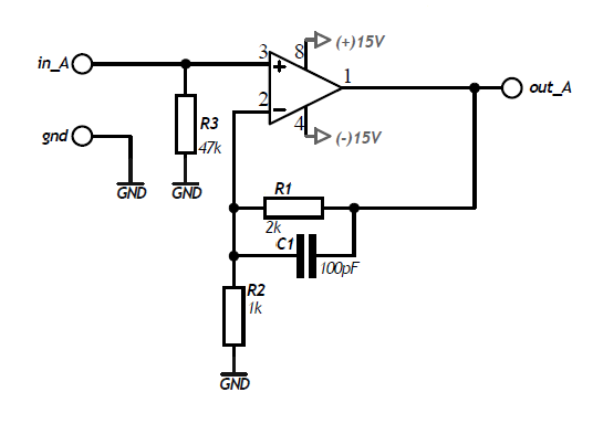

Hi Winterstone
Nice trick, I never see this method. But what about non inverting amplifier? How can we apply this method?

Hi Jony - I wouldn`t consider this method as a "trick".
Rather, it is a method which is based on a simple feedback model.
The principle is to split the whole calculation in two resp. three steps, which are combined at the end using Black`s feedback formula.
Your Example (R3 has no influence on gain if the input signal is an ideal voltage source):
* Hf=Vd/Vin=1 with Vd=(V+) - (V-).
For Vout=0 we have V-=0 and V+=Vin. Thus Vd/Vin=V+/Vin=1
* Hr=Vd/Vout (with Vin=0).
Thus, Hr=R2/(R2+R1||sC1)
* Result for Ao=infinite (known from each textbook):
H(s)=Hf/Hr=1/Hr=1+(R1||sC1)/R2.
* For Ao finite use the formula
H(s)=Hf/(1/Ao + Hr)
Correction::
Thanks to "The electrician".
Please replace all expression "sC" by "1/sC".
