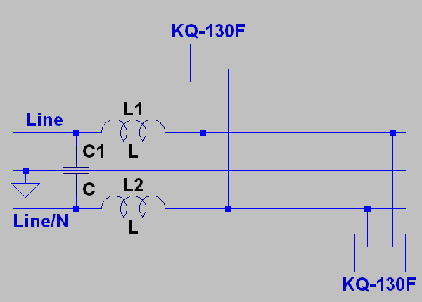

Capacitors pass high frequencies like the 130khz from the KQ-130. So the capacitors in the EN460 will short out the signals from the KQ-130.
Here I made a filter using two inductors which will open up at high frequencies. Now the signals from the KQ-130 will not pass back into the power line. All KQ-130s going to the right can talk just fine.
Capacitor C1 is optional. It will short out any 130khz signal that leaks through the inductors.

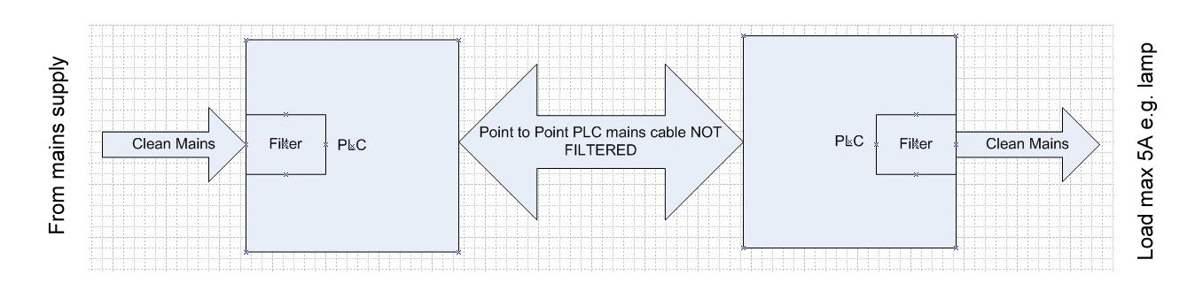

Not sure if it is me describing it badly but here is a diagram that should help, if anyone can do a quick diag / schematic with values it would help a lot as I am not confident at all about how to create this filter.
Steve
P.S. Maybe I am being a bit anal about this but as it is a P to P comms there is no need for the data to go outside the system.

MUCH more clear. that whole picture 1000 words thing is alive and well. The filters will keep your carrier current signal off the external mains lines, although in reality the signal is so low that it doesn't cause problems, especially with industrially-hardened electronics. The left and right "clean mains" go to the line side of each filter, and the left and right PLCs are powered from the load side of each filter.

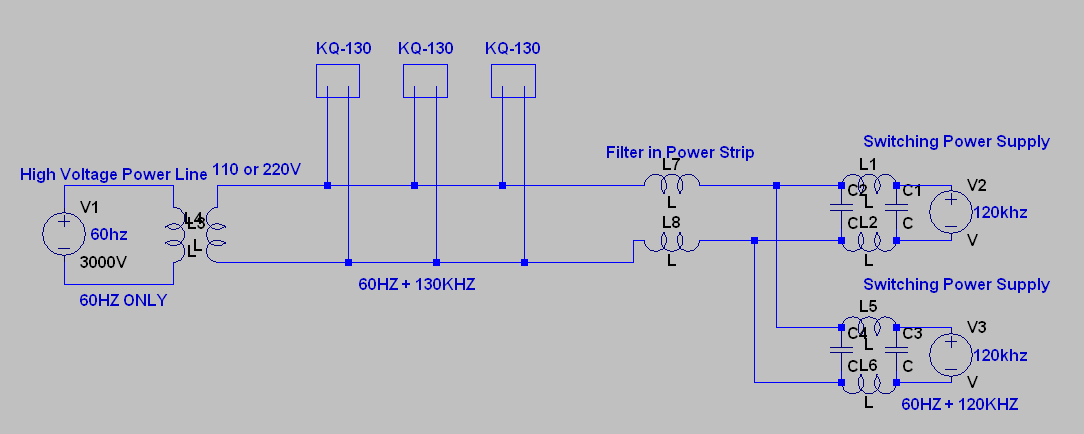

I have been using power line communications for years. I started when there were no switching power supplies in the house.
In my house:
High voltage is from the power company. There is a transformer that reduces the 3000V to 110/220V. This transformer passes 60hz and does not pass 130khz. I have tested it. Signals will not pass to the neighbors house.
Every time I added a computer with a Switching Power Supply the noise level went up and the signal level went down. Many switching supplies run in the 100 to 200khz range. This adds noise to the wires. The noise filters in side the power supplies place a large capacitor across the power line to short out the noise. (100khz range)
By the time I had 5 computers + 5 CRT monitors in the house communications was not good. So I added inductors to each power strip. (L7+L8) This 47uH choke dose not pass the high frequencies well. So most of the house has the 130khz signals on the wires. Each power strip will not allow the 130khz in and keeps the 120khz switching noise from getting on the house wiring.
This solved my problems.
I used 47uH. You will need to pass 5A and not saturate at 7A. (You said 5A load)
There is no problem with having small 130khz signals on the power line.

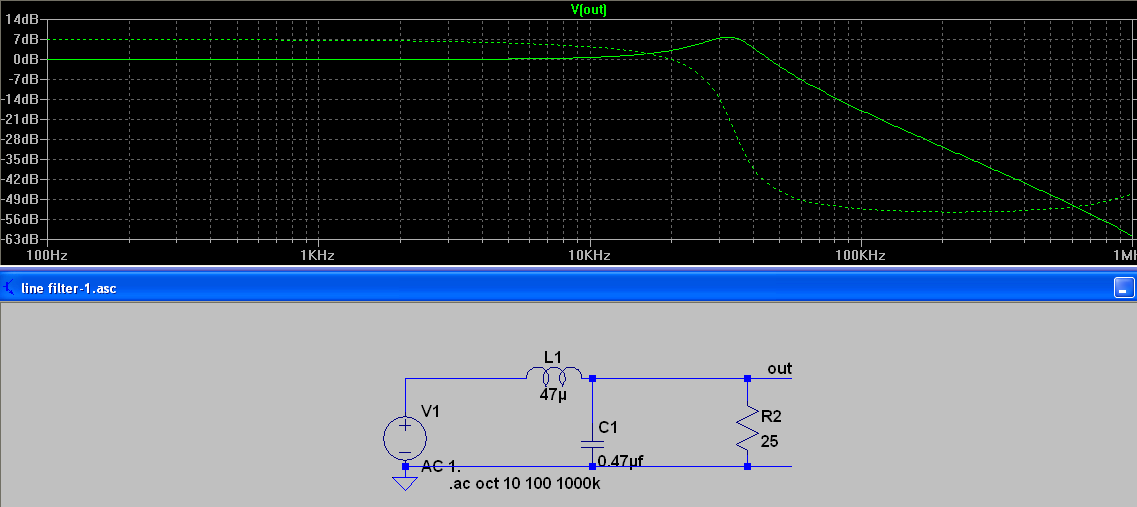

Inductor PM2110-470K-RC can be found at digikey.com 47uH 0.024 ohms, 6.5A
Capacitor 0.47uF "X" power line rated.
On the left side the 130khz sees 47uH and it can move the wire up/down in voltage.
On the right side 130khz sees a capacitor and will find low impedance.
The graph shows attenuation.
At low frequencies like 60hz (dc to 10khz) signals flow through.
At 120khz there is -23db. The signal is blocked. (some snicks through)
I don't know if this is enough attenuation. We can use more inductance or a larger cap. OR Use a LCLC filter.
This is a place to start.

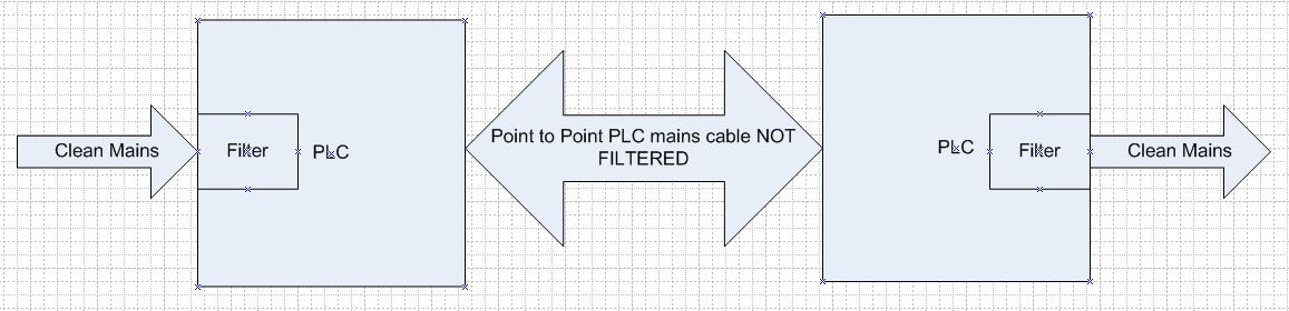

Brilliant Ron thanks a million, if I understand you diagram "out" is load and what size is that resistor "ohms + watt"
Sorry, I meant I can put a 5A load on the wires, e.g. a lamp or something. OK so I don't need the resistor. Another thought I have had is in my diagram I show two filters, this is because the boards are identical PCB's, I assume there are on issues with having two filters doing the same thing?
I don't see a need to filter the load. The lamp does not care. 50hz, 60hz, 200hz, 130khz the lamp only turns current X voltage into light+heat.
