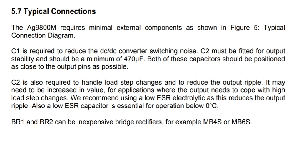

Do you have the text that describes the capacitors required on the PoE output? I imagine that the main concern would be if the PoE requires those caps for stability. If you have just enough caps directly on the output of the PoE (anode of diode) to achieve that, put everything else on the cathode of the diode.
If they're just required because the PoE can't handle the transient demand on its own, then you dont need any direclty on the output.
You might be able to wire up a PMOS some way to do the same thing as a diode but with the added functionality that when it gets turned on if and only if the PoE is powered, so current can pass current both ways so then you don't have to worry about which side the caps are on.

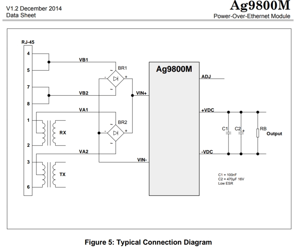

The PoE is a Silverel AG9800M. Datasheet
The caps are required for stability it sounds like. The AG9800M actually wants 470uF - the AG9900M only needs 2 x 100uF. The pertinent text and diagram are posted below.
I guess this answers my question. Additional caps downstream of the diode may be beneficial?
I guess it would be beneficial, but...diminishing returns. I'd see if you can't wire up a PMOS like how I suggested that is driven by the output of the PoE module. Maybe it can be driven somehow by the unstable output of the PoE on startup and then turn on and connect the rest of the capacitance and end up allowing for stability. Could also be more trouble than its worth.
