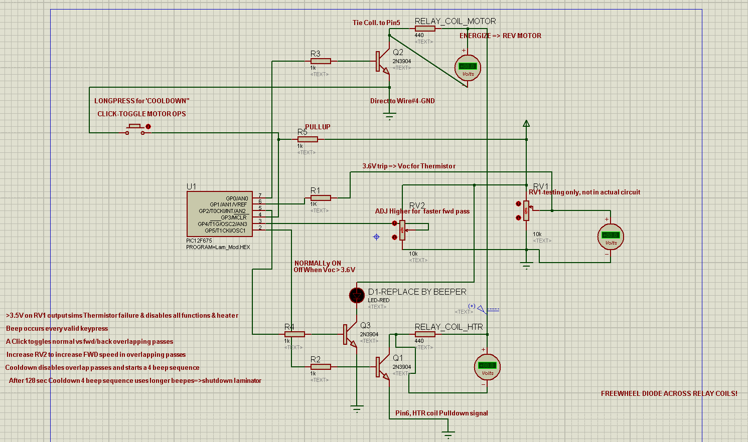

Well, I got the laminator and I viewed various blogs & you tube videos on modding it for regular magazine paper use.
Here's the plan:
1) Add over temperature protection (for a failed/broken thermistor) as it has none.
2) Add an automatic forward /rev motor cycle option to create multiple, small, overlapping passes of toner transfer for a single pass of the copper clad board. Perhaps 1 sec forward, 3/4 sec back, ratio timer , thus slowing the speed down about 4 times.
Use a trimmer pot to permit adjustment for net slower operation with more cycles.
Since the motor is an AC synchronous unit, I can't use a triac chopper speed control.
3) Add a 2 minute cooldown over ride to permit roller cooldown while allowing the original temp setting (persistent) to remain. Add a beeper to signify when to shutdown power manually.
I plan to use a 12F675 PIC to do the job. The add on PCB will align with existing holes on the casing and be compatible with the 6 pin 0.1" pitch headers of the existing control board to permit simple plug & play.
I can publish the design and PIC code here when it's done.

Yes...there is a relay that swaps the stator polarity. It has a 1.55uF 630V Poly snubber cap sitting on the relay terminals.

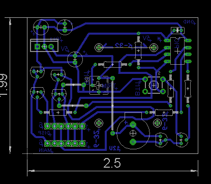

I completed the laminator mod simulation last night and the uC coding. I am designing the PCB for it now and I should have results soon!
Throbscottle: I'll do a thru hole prototype so it's easy to duplicate.
Edit:
This is the PCB design. I'll build it tonite or tomorrow.

Popped into a gentle bath of dilute nitric @ 1160 spec. gravity yielded a good etch 20 mins later, including the text and numbering etched into the copper as per the design shown.
