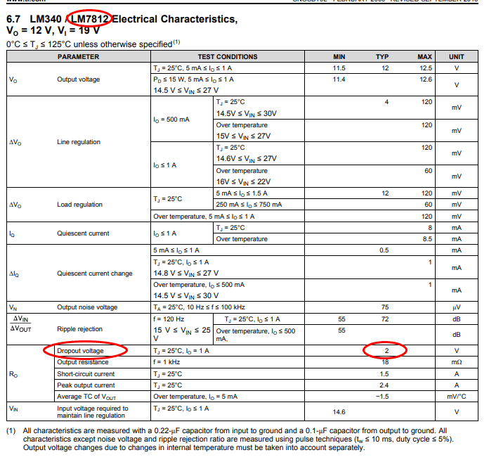

I have a board which I want to use for two different projects. They need different input voltages - 12V and 18V. Part of the board can be safely powered from 7-12V. I'm thinking of using a 7812 to regulate the input voltage. When fed 18V it'll produce 12V but what will it produce if fed 12V - I'm (guessing) hoping it'll be around 10V, the datasheet states a dropout voltage of 2V,
Will this be OK?

I've have a 7812 set up on a stripboard with the smoothing caps according to the datasheet and nothing else (load) connected to it .. .. I put exactly 12vdc in and 11.27 vdc came out .. .. .. .
Does that help ?

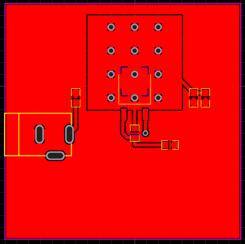

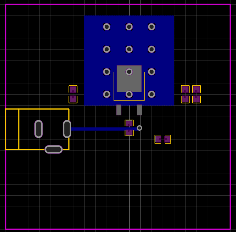

I've now got a 1117 with, what I think is, an adequate heatsink. I've drawn a separate schematic to demonstrate,
On the circuit board I've define 2 copper pours around the 1117 and a Ground pour on the top layer,
The top and bottom layers are connected with 12 pads arranged as shown.
If I turn off the top layer then the bottom area is shown,
The area is 25mm (1") by 20mm (0.8") with the 12 connecting vias (actually pads).
Is there a way to calculate the wattage this package/heatsink combo can dissipate?
Any comments/advice greatly appreciated.
Edit, just discovered I can change the "Pad Connection" on the pour to solid (from spoke) to get a solid area.

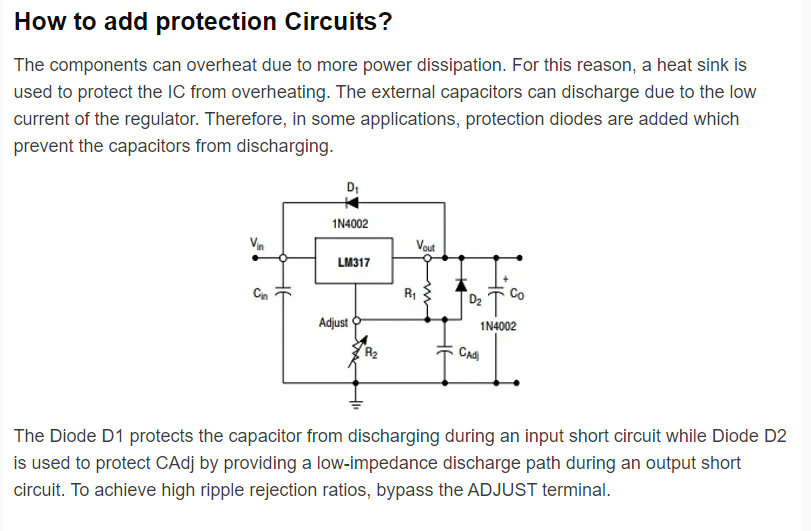

It there any chance the output will have voltage on it while the input does not? A forward-biased diode from output to input will protect the voltage regulator if this ever happens.

I don't have a LM7812 but I have an LM7815.
If the input voltage is below 15v+2v(DO voltage), the output follows the input minus a few millivolts, if unloaded.
If loaded, the output voltage drops relative to the load current (an increase in load current causes a greater voltage drop). So basically, it doesn't regulate the voltage if the input voltage is less than 2V greater than the spec'd output voltage.
